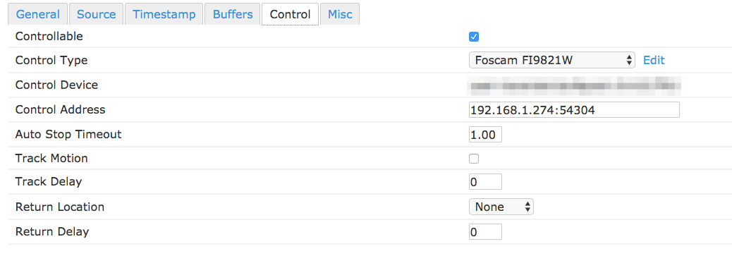

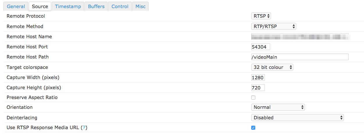

Below are my settings:
The error that I am seeing repeated in the logs when I attempt to move the camera is as follows:
Error check failed: '500 Can't connect to 192.168.1.274:54304'

Control Device is the user name for the camera that has control authority. Usually the admin user or operator
Control address is the camera IP address. Do not think you need the port.

Removing the port now throws this error
Error check failed: '500 Can't connect to 192.168.1.274:80'

Where did port 54304 come from? My 9821 works fine exactly as bbunge described.
The 9821W is what I do my development with. Never had a problem with it. Pretty sure the firmware is the same as the 9821P.
If you just put in the password to the admin user in the control device field, zoneminder will assume a username of "admin".
Here are the instructions for your camera:
https://wiki.zoneminder.com/Foscam_FI8921P
These instructions probably apply too since both flavors likely have the same firmware.
https://wiki.zoneminder.com/Foscam_FI9821W_V2

As far as the port number, I was using the Owlr iOS app and I think it changed the port to that. Ill try changing the port to 80 although any port should work, am I correct in that assumption?
EDIT
Changed settings based on those two articles.
Getting Error check failed: '500 Can't connect to 192.168.1.274:80' while using the FI9821W profile. If I switch to the FI9821P script (this was custom I believe) I get the following error:
Control response was status = undefined
message = /usr/bin/zmcontrol.pl --panspeed=2 --autostop --command=moveConRight --id=2=>
thelavender

Forget the app.
Instead point a web browser to the camera, log in with the admin credentials, and then look for the port number.
On mine it is under Network -> Port
Of course, if the HTTP port isn't already set to 80, then your browser probably won't connect to it. You will need to determine the correct port number your camera is listening on for HTTP requests. Once you do that, confirm your settings with a web browser, then use the correct port in ZoneMinder.

I had gone ahead and reset the port to 80. I updated ZoneMinder to use this port. I also made sure that I was just including the password in the Control Device field. I am just getting the error Error check failed: '500 Can't connect to 192.168.1.274:80' now.
Re: Unable to control Foscam
But did you make that change from an app, or did you do that through a web browser?
If you can't connect to your camera's web portal using a web browser, then the ptz commands are not likely to work.
