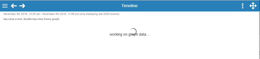

Hi all, have a working zoneminder with 5 cams since some years back. Installed zmNinja app on my iPhone some months ago and I can't get the timeline to work. Live view (montage) is fine but when I press Timeline nothing happens. Tried to run zmNinja on my win10 with the same behaviour.
The log shows **exception** but I can't really understand what to look for.
Nov 4, 2016 10:16 AM INFO multi server list loaded{"servers":[]}
Nov 4, 2016 10:16 AM DEBUG **EXCEPTION**TypeError: Cannot read property 'pageCount' of undefined caused by undefined
Nov 4, 2016 10:16 AM INFO Monitor load was successful, loaded 5 monitors
Nov 4, 2016 10:16 AM DEBUG Now trying to get multi-server data, if present
Nov 4, 2016 10:16 AM DEBUG TimelineCtrl/drawgraph: graphLoaded:false
API works, and I upgraded ZM from 1.29 to 1.30 yesterday with the same result.
Please advise.
BR
/AGW

Re: Timeline not working
That error almost always means your APIs are broken.
How exactly did you upgrade, which instructions did you follow and which Distro?

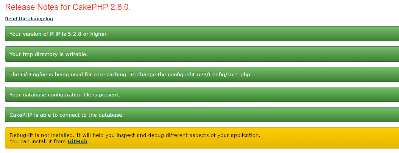

Ok, http://<server>/zm/api/events.json doesn't work at all, nothing happens.
Ah you said:
I think I know what may be going on.
Edit /usr/share/zoneminder/www/api/app/Config/database.php
and uncomment the 'encoding' => 'utf8' line in the DATABASE_CONFIG for $default
It should look like this:
Then try the events API again
class DATABASE_CONFIG {
public $default = array(
'datasource' => 'Database/Mysql',
'persistent' => false,
'login' => ZM_DB_USER,
'password' => ZM_DB_PASS,
'database' => ZM_DB_NAME,
'prefix' => '',
'encoding' => 'utf8',
Thanks! Problem solved!
