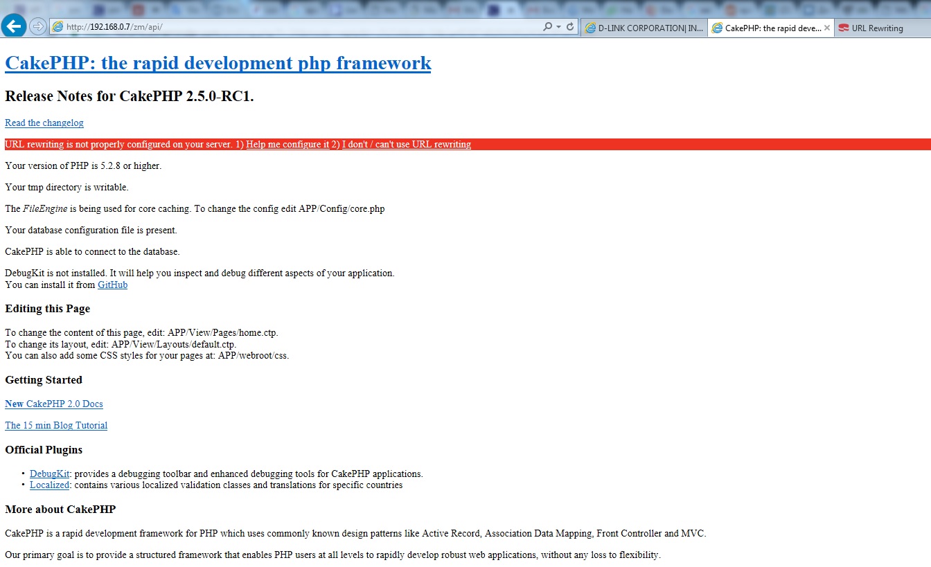

hi, asker!
We have same problem weet API. ZM works good, but our chief wants to explore cameras from he's smartphone (iPhone 6). We have bought zmninja from AppMarket, then install it, But ZMNinja request an API.
My API doesn't work, i' got error (see attachment)
What would i do?
Linux Debian 8.0
ZM 1.29.0
I'm trying by your steps:
What would i do?
Linux Debian 8.0
ZM 1.29.0

- cakephp error.jpg (205.75 KiB) Viewed 8340 times

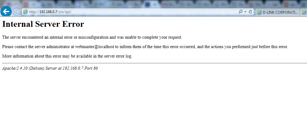

Re: API configuration issues
Thanx, i tried to
then try to open.
I have no upgrade to 1.29.0
Clear install was be with 1.29.0 version.
root@stk-video-01:/etc/apache2# cp /usr/share/zoneminder/www/api/app/.htaccess /usr/share/zoneminder/www/api/.htaccess
- internal error.jpg (68.25 KiB) Viewed 8299 times

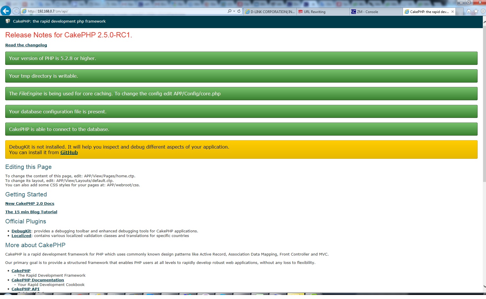

Thanx a lot, asker!
I have solved my problem.
Problem was in file:
In this case API doesn't work. But i turn on my other ZM server and make:
Then, i corrected my /usr/share/zoneminder/www/api/.htaccess file and paste "app", reload apache2 and GOOD!
THANX!
root@stk-video-01:/usr/share/zoneminder/www/api# cat /usr/share/zoneminder/www/api/.htaccess
<IfModule mod_rewrite.c>
RewriteEngine on
RewriteRule ^$ /webroot/ [L]
RewriteRule (.*) /webroot/$1 [L]
RewriteBase /zm/api
</IfModule>
RewriteEngine on
RewriteRule ^$ app/webroot/ [L]
RewriteRule (.*) app/webroot/$1 [L]
RewriteBase /zm/api
</IfModule>
THANX!
- api_work.jpg (331.79 KiB) Viewed 8296 times
