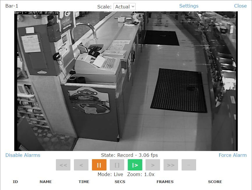

I upgraded a server for a local bowling alley after a hard drive failure, figured it would be a good time to move off of the old Ubuntu 10.04 Server since it would be a re-install anyway. Since the upgrade to the newer server environment and going from ZM 1.26 to 1.29 the live view and recordings on all of the CCTV cameras has been crisp and clear for anything stationary, but anything moving will blur.

The business had a couple power outages about 6 months prior to the primary drive(s) failure which also led to the discovery of a faulty UPS for the server. Had to replace both 250GB and one of the 1TB drives since they where showing a large amount of bad sectors. The lone surviving drive was extensively tested and showed no errors. Prior to the failure the whole system worked great, clear video on live and recorded playback. I am kind of lost why this is happening and what to explore further. I have tried adjusting the "Blending" from none to 50% with no success, different cameras and cables as well. All settings are consistent between cameras with the obvious exception of the input.

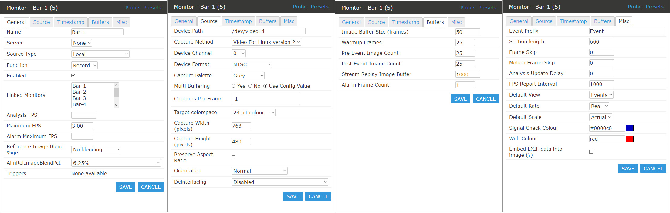

Well based on the direction you sent me in, I was able to find some more specific areas to explore in the settings. It seems that these capture cards are only happy when interlacing is enabled. Switched all the source settings to "V4L2-INTERLACED" and everything is clear in the video now. I will have to keep an eye on things for awhile to make sure this doen't have an adverse effect somewhere else, but for now I will call this one solved.

Well it appears after the cameras started feeding more movement to the capture card the previous setting stopped being effective. The setting worked fine with minimal movement, but when the lanes started filling with people then the videos became blurred again. Changed the "Deinterlaced" setting to "Discard" and that has been working well for an hour now. If this changes I will update.
