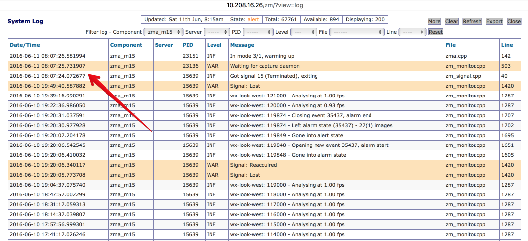

I get the same thing. When a camera goes white, I click the IP in source, re-save the existing settings, and the camera is back (for a while at least).

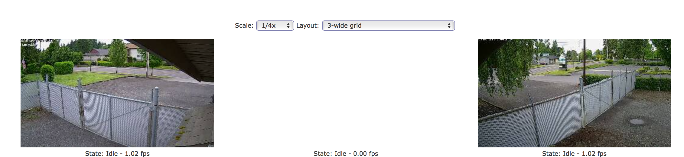

Here is what I see when a camera goes white:
And here is the log of what happened when it went white. (The red arrow is when I reset it.)

Let's try that again.

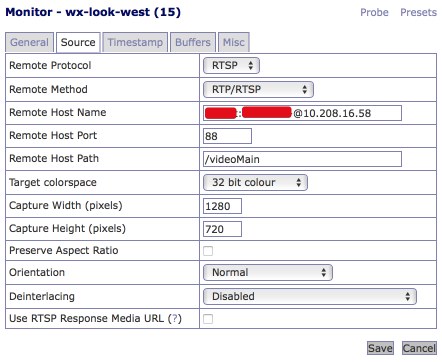

try to get the camera stream over rtp/rtsp instead of the http picture. that solved my problem.

Thank you. I am converting all cams to rtp/rtsp now. Time will tell if I get the white out. Again, I really appreciate the post.

rtp/rtsp did the trick. Thank you again.
For others reading this...
See attached. u and p are in red.
