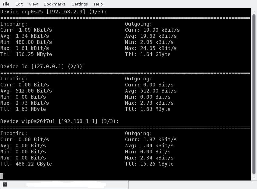

After 3 days of uninterrupted performance all 4 cameras stopped transmitting (or at least the data does not get through to zoneminder)
The cameras are wireless and they transmit to a wireless interface which right now shows zero bytes receiving. The result being that neither the https, or api viewing of cameras is not available. I am 99% sure that if i reboot the system everything will go back to normal. But before I do that I would like to know why it happened.
Can you please help me get the necessatry bits of information in diagnosing the problem?
What I checked so far?
nload -m
shows no incoming packets on the "wlan0" (wlp0s26f7u1) interface.
