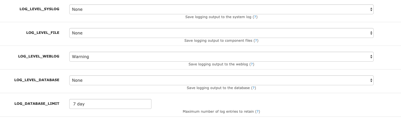

You either need to:
1. Change the zoneminder log location in fail2ban's jail conf for zoneminder to your OS syslog
2. Enable web logging for warning level logs (Zoneminder web interface > Options > Logging > LOG_LEVEL_WEBLOG > Warning)

gmar_87 wrote: Fri Feb 15, 2019 10:23 am
You either need to:
Thank you for your answer gmar_87 :)
I used the second solution, I just had to change the [:error\] to [php7:notice\] in the regex of my zoneminder for my case and now It's perfectly working :D
