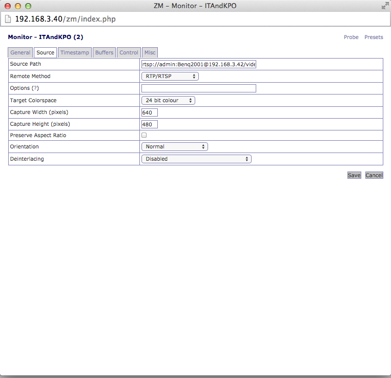

Also please find the attached file that i have configured cameras on 1.28.1 zoneminder version and same setting not working on 1.29

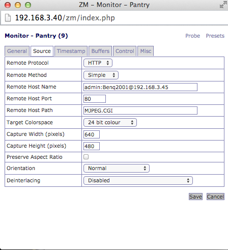

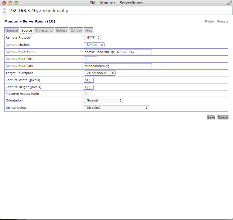

- Screen Shot 2016-02-11 at 4.12.29 PM.png (61.95 KiB) Viewed 13106 times
- Screen Shot 2016-02-11 at 4.12.50 PM.png (49.05 KiB) Viewed 13106 times
- Screen Shot 2016-02-11 at 4.11.48 PM.png (57.97 KiB) Viewed 13106 times
