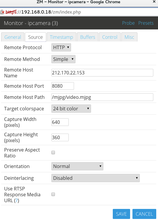

Hello, zoneminder was installed from zmrepo for fedora 23.
I am trying to connect the following public camera just for testing:
http://212.170.22.153:8080/mjpg/video.mjpg
It works in firefox and chrome. It seems to be set as 640x360
I set everything up in zoneminder as seen in the attachment. The log however is showing that:
2016-01-29 12:34:35.806950 web_php 7104 ERR socket_sendto( /var/lib/zoneminder/sock/zms-922918s.sock ) failed: No such file or directory /usr/share/zoneminder/www/includes/functions.php 2371
2016-01-29 12:34:25.434190 zmdc 8601 WAR Can't find process with command of 'zma -m 3' zmdc.pl
Do you have any hints for me?
Thank you

- Screenshot from 2016-01-29 12-34-07.png (60.65 KiB) Viewed 6393 times
