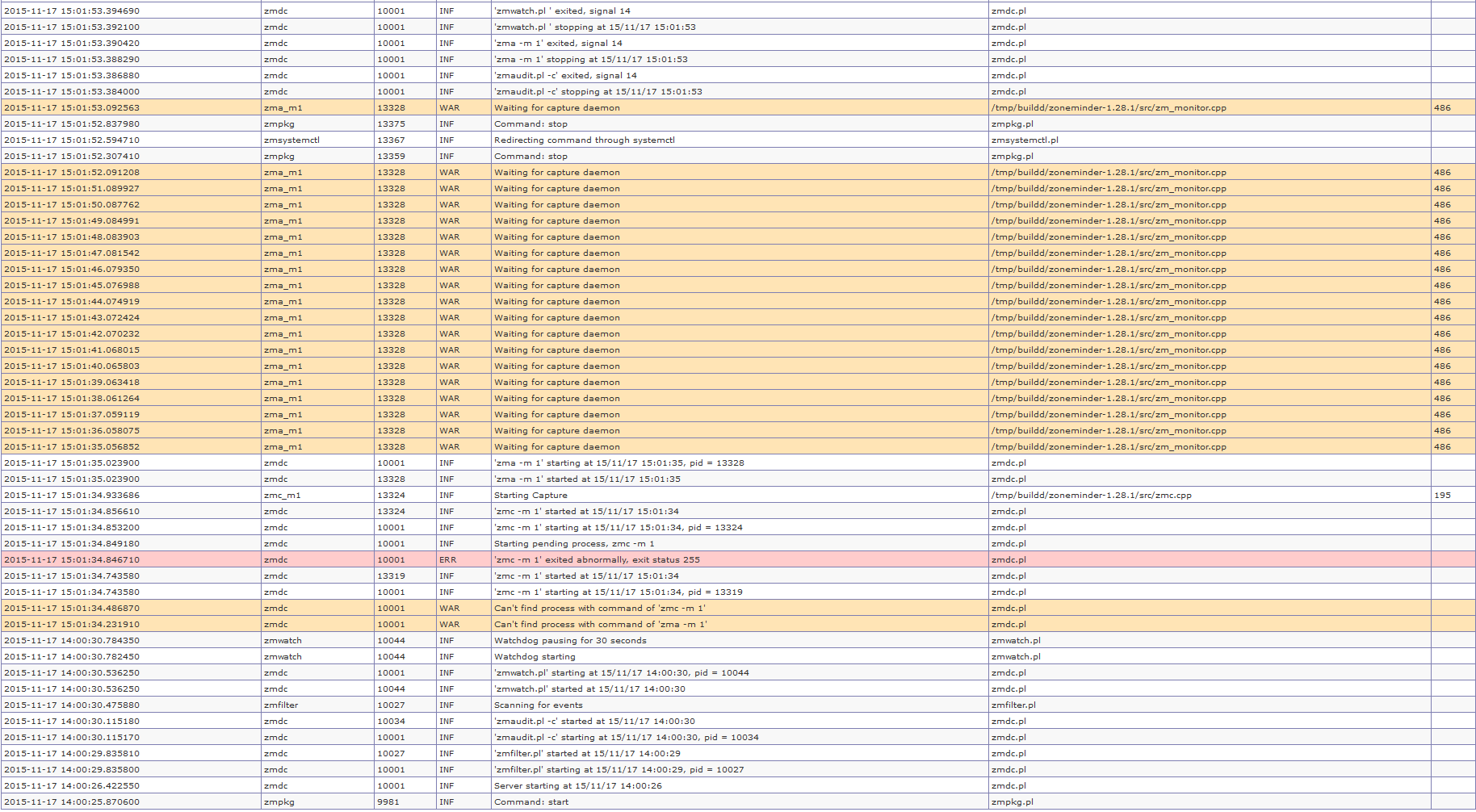

Hey, i have a Problem by setting up zoneminder.
Now ive installed zm 5 times (every time an other source or by package) and every time ive got the same problem with the "Waiting for capture daemon" error.
Sometimes of the 5 installations it works until ive restarted my system.
On the Internet i could not find anything to fix this problem.
Hope you can help me here
Sry for my bad english... I hope you can understand me.

The resolution settings seems not to be the problem. I my cam-device settings is written that the cam use 640x480 and in zm i inserted the same.
I dont understand why zm works after i installed it for the first time on any distribution until i restart the system zm does not work anyway and just show me this annoying "Waiting for capture daemon" warning...

Now i have reinstalled again zm with adding the "sleep 15" and i got the same problem agin.
I use a Foscam FI8904W with the configurations for video streaming from the wiki: https://wiki.zoneminder.com/Foscam_FI8904W
