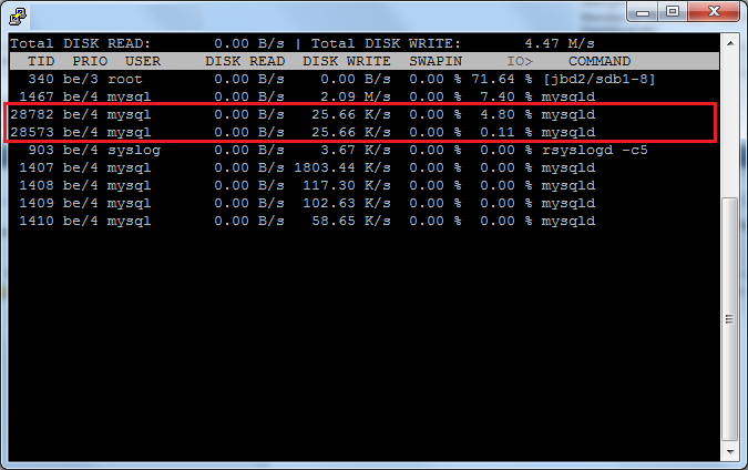

I am using pc only for record motion from cameras, nothing else. HDD is still writing, LED diode still flickering and also can hear that drive is busy. Both cameras are set to "modect" so i am not recording everything, only when motion is detected. If I stop zoneminder, hdd stops too, when start ZM, HDD start writing. Sending printscreen of iotop, inside red rectangle are two processes which are there all the time, other ones not still running "only" about once every 10 sec. In event directory appears only detected motion situations, which is right, if there is no motion, no new files are appearing.

Did you enable high verbosity for debug or there are a lot of warning or error? I have seen case when there is a lot of logging activity (check the log link on the console which you can see) , mysqld will take a lot of CPU time and so as the HDD activity.

Oooo I forgot about debug! Zoneminder does a lot of logging through syslogd (into /var/log/syslog or /var/log/zm/zm/log) and also puts it all in the SQL database. If you have a high level of debug/errors occurring, you will see lots of activity :)
It's chatty enough in normal operation, never mind more verbose levels.

I just set LOG_LEVEL_SYSLOG and LOG_LEVEL_DATABASE to none and now it is all perfect. CPU usage drops to 20% from 85-90% and disk is no more writing like crazy :-) I never played with settings on Logging tab, all settings was default so i didnt expected it could be something wrong there. Thanks for your help, hope my HDD will survive this without much damage :-) It is old drive, but still working.
