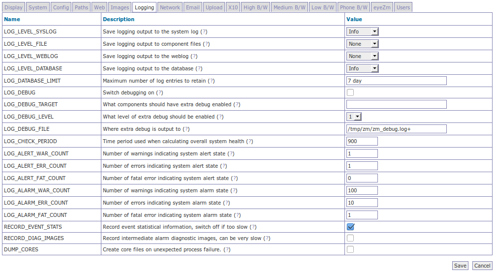

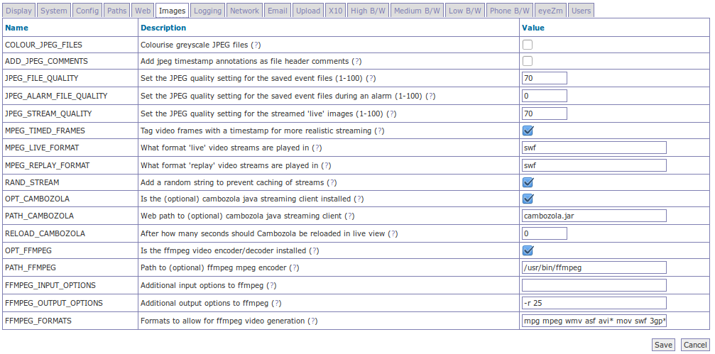

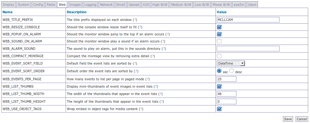

Here are my current settings, maybe someone here can find some problems in my settings. :) (or if you find points where to be improved, than let me know pls.)
Greetings,
Laszlo
Ubuntu Server 14.04.3LTS 64bit - ZoneMinder v1.32.3 - 2x AV-Tech AVN257 IP Cam; 1x Hikvision DS-2CD2020F-I IP Cam

mcll
Posts: 33
Joined: Tue Feb 11, 2014 9:26 am
Location: Hungary
Re: Interesting picture
Post by mcll »
Sorry for the pictures.. ;)
Email, Upload and X10 options are disabled.
Greetings,
Laszlo

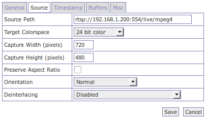

When you were suggested to leave the Maximum FPS blank -- that needs to be in ZoneMinder, not the camera. At the camera, set the framerate you want. At ZoneMinder, set it BLANK, and it will deal with whatever the camera throws at it. Do not set a FPS at both ends, even if you think it's the same, it causes trouble!
All those tabs you posted -- it's not on them -- there's more config elsewhere ... :)
Click on your "Source" link for the camera, then go to "General" tab, see "Maximum FPS" ?? Empty that field.

mikb wrote:I've seen your YouTube videos, that is data corruption in the data stream....
...All those tabs you posted -- it's not on them -- there's more config elsewhere ... :)
Yes i think it's a datat corruption. But why, what's causing it? :)
OK i have now that settings, but as i see it's already empty.
Greetings,
Laszlo

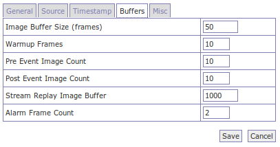

Here other camera settings:
Greetings,
Laszlo
