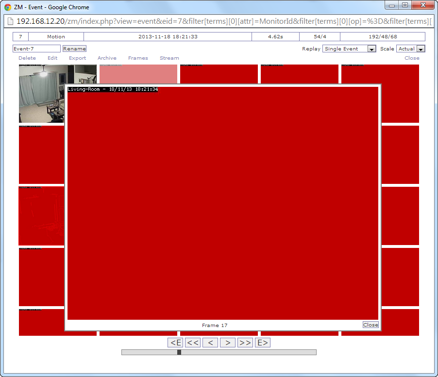

EdwinLandy
Joined: Fri Sep 27, 2013 3:10 am
Re: New problem - camera goes red
Post by EdwinLandy »
Just wanted to give my experience for any troubleshooting. I saw a Red screen after adjusting source settings. I'm using ffmpeg, H.264, with a Grandstream GXV3615. After I went to the source page and hit "save" again, it went away. No trouble since.
