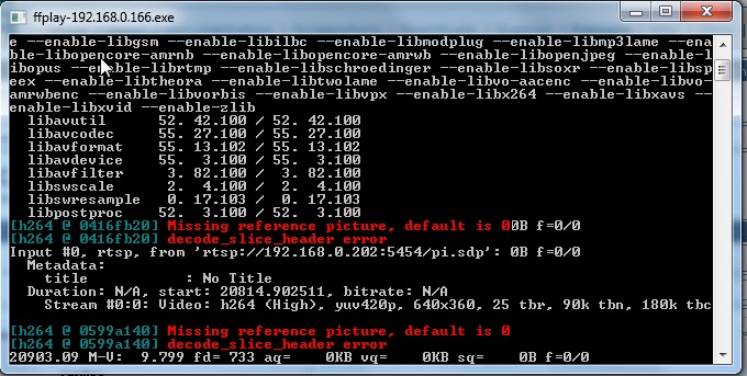

With the first method i got ~1 seconds delay, tested with filming an analog clock with a second pointer,
the recieved stream was allmost exactly 1 second delayed. Even watching the cam on the Zoneminder
true ffplay was not much difference.

Hi Jemmyn
Don't use VLC i had also strange behaviours, and much delay.
I recommend using ffmpeg instead (also on Windows)
Here is an example how to start ffplay to view the stream.
ffplay.exe -i rtsp://192.168.0.166:5454/pi.sdp
It takes some seconds to connect and i even get at the beginning some error messages but you can ignore them.
see attachement.
I think i downloaded ffmpeg from here
http://ffmpeg.zeranoe.com/builds/
you get this link also from http://www.ffmpeg.org/download.html
Good luck and tell me if i could help.
BR Markus
