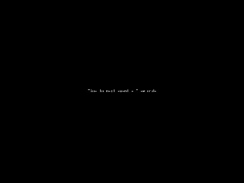

Help. What have I done?
Every time I try to play an event, I get what looks like 1 frame, then a black (event video) screen area / square.
In the middle of the screen is what looks like white text but is gibberish. [Later: I now see a countdown timer happen. Hits 1, and stops. Same black screen, nothing happens.]
Attached.
Opening the monitor window is fine, video wise. Event lists are fine. But playback of an event gives the above.

One image on event playback, then black screen?
- Text only, within black screen.
- BlackZMevent-text.png (869 Bytes) Viewed 3026 times
- Black event screen after 1 frame - illegible text inside.
- BlackZMevent-illegible text.png (1.5 KiB) Viewed 3026 times
Re: One image on event playback, then black screen?
Is this screengrab taken from the"Event" view?
The white text you call gibberish says "Time to first event = ? seconds".
This makes me think that maybe you have the event view showing "Replay: [All Events]", where it pauses and shows that screen until it's "time for" the next event, i.e. real time. The alternative is a setting of "Single Event" or "Gapless Events", where it shows the event and stops, or shows events back to back with no regard for preserving timing (respectively).
This option appears on the event view page, and is remembered, it's not under the (many) Options/Config pages!
Did you change it by accident?
