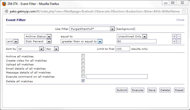

As title suggests.
I appear to have deleted the filter option PurgeWhenFull
Bit of a mistake. I would appreciate it if someone could tell me how to recover it or recreate it :S

Find attached the screen shot of my purge when full filter.
Hope it helps,
PacoLM

brilliant. much appreciated, ill report back once ive had a chance to try recreating.
