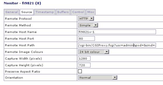

Ok, I can confirm that the camera works in dumb frame capture mode.
I only get 4-5fps, and the jpegs clearly look worse than the real video from the camera, but I suppose that it's better than nothing while waiting for RSTP support.
Attached is the config screen. The truncated field is here:
/cgi-bin/CGIProxy.fcgi?usr=admin&pwd=&cmd=snapPicture2
