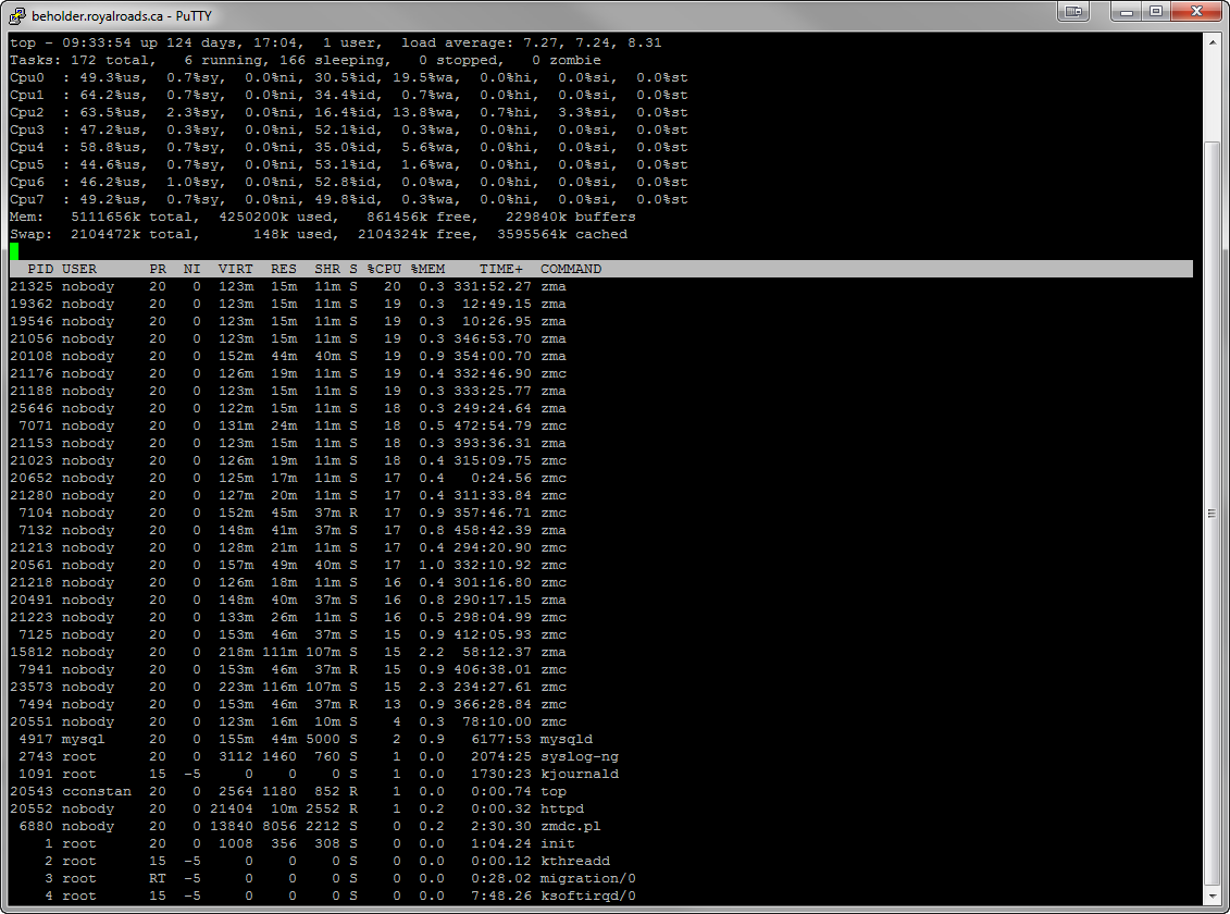

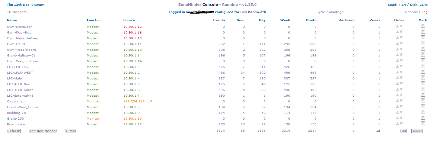

Yes 8 as in 8 as the top command will show. We run 18 cameras, all IP based, all but a couple are in motdect mode. All but the main cameras are AXIS cameras. The Gym Cameras are cheap DLink IP cameras as they don't need to have the features of the AXIS cameras. And one other camera is different.
See attached Screenshots.
The screenshot shows a different load just because it was done at a different time. But fact is it takes forever and a day to log into the system. It takes forever and a day to 'reconnect' a camera that ZoneMinder 'looses' (just click the ip and click save is usually enough to fix it, but it shouldn't happen at all). The red cameras at the top are disabled as they were taken out by an electrical storm blowing the transformer. We just haven't replaced them yet.
AXIS Cameras seem to 'lock up' a lot when being monitored throughout the day by security. Happens in Firefox and IE. Lots of functions are slow to respond. This is a decently powered server (2 quad core CPUs), running Open Suse in a rack in our server room.
$> uname -a
$> Linux security 2.6.27.7-9-pae #1 SMP 2008-12-04 18:10:04 +0100 i686 i686 i386 GNU/Linux
Any help is appreciated because something is sure amiss.
- List of cameras
- beholder-cameras.png (65.8 KiB) Viewed 7585 times
- beholder-top.png (133.68 KiB) Viewed 7585 times

red cameras are disabled. We actually look at the other ones from time to time. The 'lab' one with the 169.x.x.x ip is also supposed to be disabled, but all the cameras show up here. It still doesn't solve the problem I am experiencing, even when all cameras are live. Same problem 5min login to access cameras. Long time to access certain features also. It's nutso and just shouldn't be.

Red means the camera isn't currently connected, but ZM is tyring to connect to it. If you haven't already you should click the motdect and set it to NONE. This actually places that monitor offline in ZM and it won't waste time trying to connect to it.
