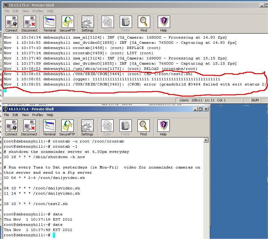

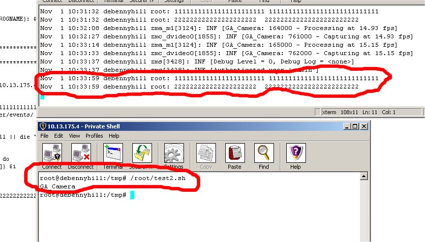

When I run the script from the terminal I get no problems. She this pic 1 script
When I run it from a cron job it dies. She this jpg attached She this pic 2 script
I've narrowed it down to the creation of the array in line 5. I know line 5 works. In fact even if I rem out line 5 and unrem line 6 the same thing happens. see the 2ns jpg above, the log file part.

Solved!
# !/bin/bash has got a space in it!!!!
It should be:
#!/bin/bash which is obvious but weird that it worked partially with the space.
Script is running find now.
