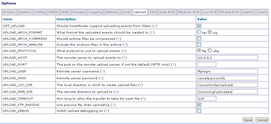

- This is the settings for "Options -> Upload" FTP.
- options-ftp.jpg (76.23 KiB) Viewed 11015 times

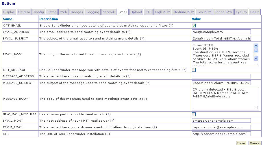

- Settings for "Options -> Email".
- options-email.jpg (85.81 KiB) Viewed 11015 times

Re: ZoneMinder 1.25.x doesn't upload to FTP server or send e
Apache might not have a login shell, maybe something like 'su - apache -s /bin/bash' will get you where you need to be http://wiki.networksecuritytoolkit.org/ ... ced_Topics
Email - I might be wrong but I think ZM expects the SMTP server to use port 25. To configure ZM to use a different port is something I have no experience of. You could try 'ftp.ftp83plus.net:465' under "The host address of your SMTP mail server" but I'd guess that won't work.
FTP - As any user on your server try FTP'ing a file to 'ftp.ftp83plus.net' to make sure something can get there. If it can then perhaps it's a local permissions problem? Maybe the local account ZM uses to FTP cannot read the tar file within '/var/lib/zoneminder/temp/'?
strtotime - Maybe this is as a result of adding a filter to stop ZM filling up your disk? There appears to be a solution here http://www.zoneminder.com/forums/viewto ... ime#p77689
The email server doesn't accept telnet connections on port 25, and closed it sooner or later before I could perform the test. However, I have experienced it to be working when I was using BlueIris (Windows),which has an option to send alerts by email, SMS, as well as upload to FTP (No SFTP, though). So probably not an email server issue. In fact, each time I had to debug something communicating with my distant server, each time it was a local issue, not a server issue. I can praise its stability.
I've seen this before with FTP creating files of size zero on the server, I'm convinced it's a local permissions problem. The account handling the FTP upload does not have permission to access the file and upload it, all it does is create the filename on the server but that's as far as it gets.
It's also worth checking you don't have any firewall rules enabled on your ZM box that might affect things.
Rinstalled from scratch on a different distro. Same result: can't upload. Means useless DVR.
TAR or ZIP files aren't created.
How do I solve this?
Perhaps a missing perl library? I encountered this bug attempting to use SFTP:
Google: missing sftp zoneminder 1006890
or sudo apt-get install libnet-sftp-foreign-perl
After I resolved the dependency issue, it worked flawlessly.
I tried about ten different ways to post an obfuscated link to the bug report... apparently I'm too much of a n00b to post...
P.S.: to forum mods... perhaps turn down the link police a notch? Sheesh.
