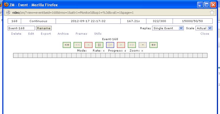

Why can I not see images in the main camera window, see them in any event I try to view, but if I export them, the exported 'index.html' has a viewer that works just fine?

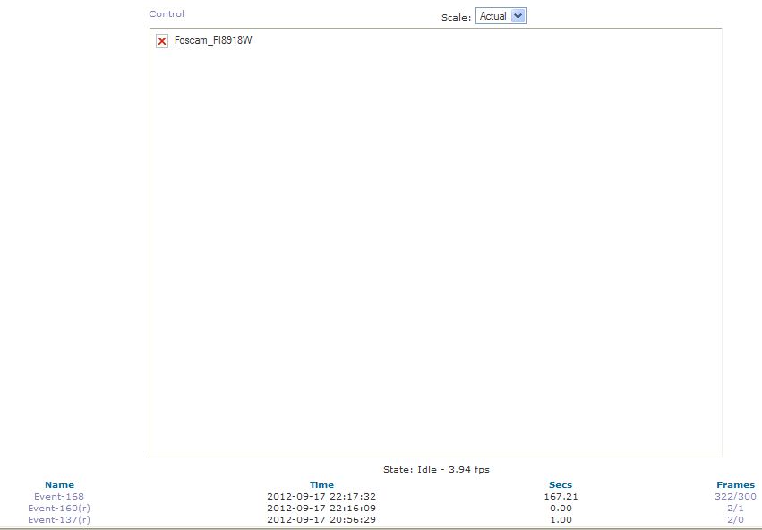

I mean that I cannot see images:
This screen should show images down below the line of squares, I think:
So I'm unable to see video.
