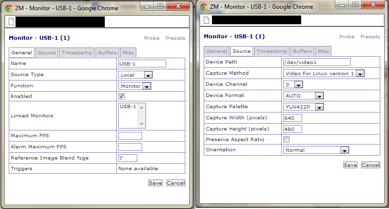

I'm working on getting ZoneMinder up & running on an old netbook (EEE900HA). It has a Rosewell WebCam connected. The OS is Ubuntu Server 12.04 LTS (32-bit).
I've got it all installed and can access the webpage. I've got Camobolza installed as well.

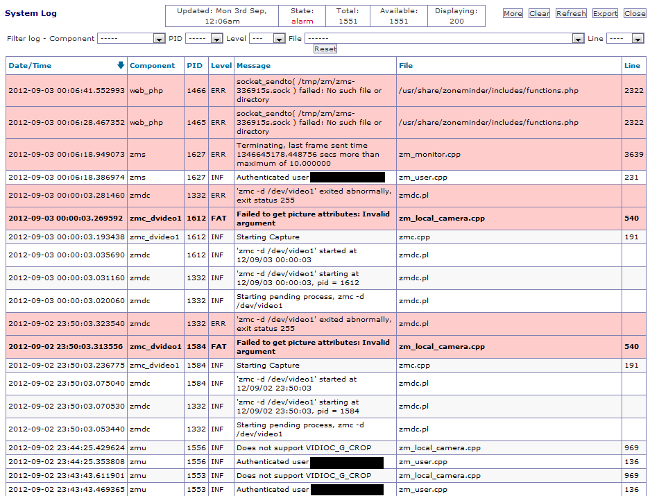

I am, however, not getting feed when I try to view the camera. The error "Failed to get picture attributes: Invalid argument" is the most interesting thing to appear in the log as far as I can tell.

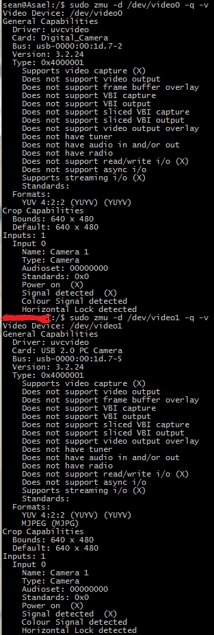

A screenshot of the system log, a screenshot of the attributes of the attached webcams (I believe /dev/video0 is the internal webcam and /dev/video1 is the external USB webcam. I am attempting to use the external USB webcam), and a screenshot of the camera settings (I've tried a few variations with no luck) are attached.
I've searched the web & wiki for my error message and have found next to nothing about it.

I can't say it "doesn't work" but I haven't gotten it to work yet.
When I said I had tried a variety of settings that included using Video For Linux Version 2. I was unable to tell what some of the settings should be from looking at the output of zmu -q. For instance, Device Format & Device Channel. I switched over to Video For Linux Version 1 because it had AUTO as an option for Device Format.
Sean

I agree with it looking like YUV422 is correct for the Palette (based on the output from zmu -q). However, I still don't know what the "Device Format" is supposed to be. This NTSC, PAL, etc.
