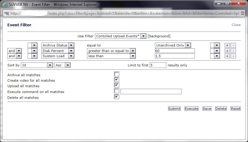

Hello all,
Related to my request for help / support, I did some thinking and found a workable sollution to get this done.
It is not perfect, but it works for now!!
See attached screenshot of the filter I use.
I still prefer to run this filter "Controlled Upload Event Filter" by cron, but for now it's the best I can get!
Who has a better ID?
Regards, Christo
Regards, Christo

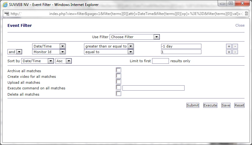

On a slightly related note - do you happen to know how to setup a filter that will erase recordings after X amount days as opposed to when the disk reaches a certain percent? I have all my 'alarms' uploaded right away to my FTP server, but I don't see a need to have the events visible for more than 7 days or 10 days...

Hello McFuzz,McFuzz wrote:On a slightly related note - do you happen to know how to setup a filter that will erase recordings after X amount days as opposed to when the disk reaches a certain percent? I have all my 'alarms' uploaded right away to my FTP server, but I don't see a need to have the events visible for more than 7 days or 10 days...
Also - I noticed that when creating filters, you can create a video but the video is not uploaded in the compressed archive
For automatic Erase events after a few days you should add the the - #day setting to a special made delete filter.
(see example that I have uploaded within this post on "Running filter on cron".
If a video is not generated on an event (flield unmarked), this video can not be uploaded, so check if the filter that generated these events, has this field (generated video) marked.
Regards, Christo

Hi Christ,
A bit confused here... I don't have a "days" option on the far left drop down menu; perhaps you mean Time?
Thanks!
Thanks!
Re: Running filter on cron
Hello McFuss,
I have added a screenshot, to show you how this must be done.
Just play with the setting and try "submit" (without the marked delete box) to know if you have the required settings.
Goodluck and regards, Christo
- Filter.jpg (78.06 KiB) Viewed 8675 times

Christo wrote:Hello McFuss,
Awesome - thanks!!
Your welkom!!
And you can also use an input like: -#hour or -#month
Kind regards, Christo
