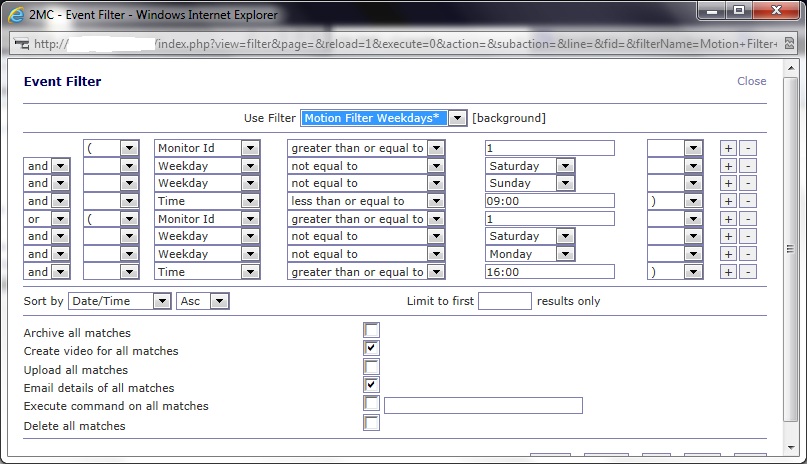

Hello frankster,
Because a picture can tell so much more... I have added a screenshot of a filter I use to get the alerts (E-mails).
Regards, Christo
Regards, Christo

Re: Programatically disabling filter/emails
Ah Christo now I see your picture I understand your previous post! but my comings and goings are not so predictable - thanks for the idea though.
