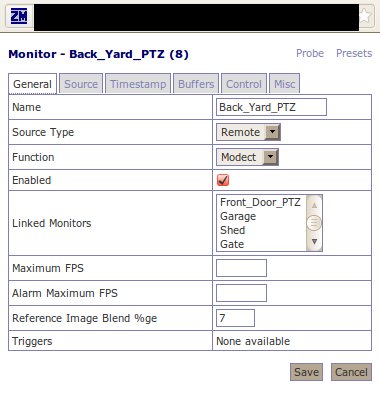

You should see the other cameras listed, but not highlighted.
I've attached a screenshot of what I'm talking about.
None of the cameras in the screenshot are linked.
For this test, I recommend you run with just one camera. It'll make things easier to figure out what is going on.

What I like to do is take a close look at the "score" of the frames that are detected as motion. Clicking the number in the Frame Id column should open an image with what the software saw as motion (it will be outlined in red). I find it very helpful when I can actually see what the software identified as motion. Based on these frames, you should be able to estimate a score, below which is just noise and above which is legitimate motion.
Now, enter that number into the Min Pixel Threshold field. Now test.
Chances are you will still need to tweak the other motion detection parameters. For that, I encourage you to read the documentation in the Wiki as I would just be repeating what it already says.
NOTE: Every camera will be different, which is why no one can simply tell you what to set the motion parameters to. You have to figure that out for each camera you have.
