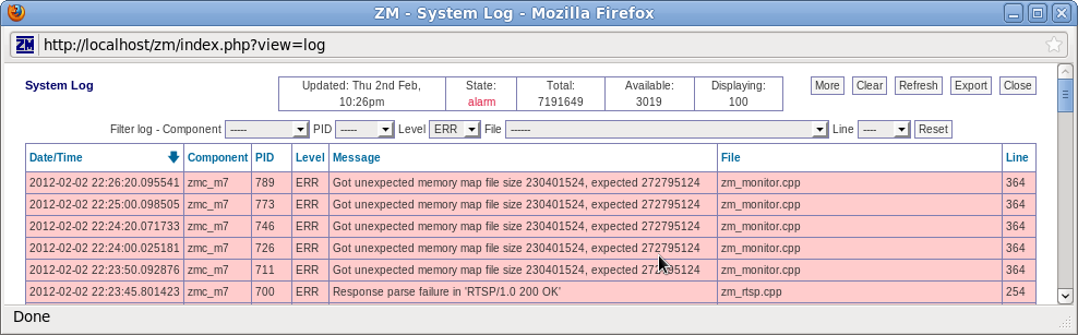

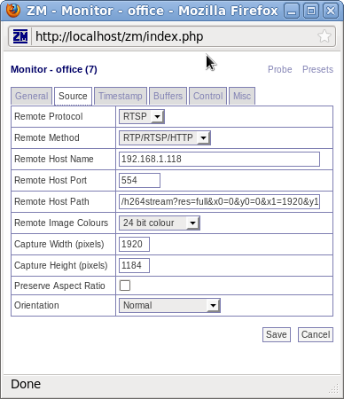

Error messages from log now are: ZM is setup up for this camera as:

- Screenshot-ZM - Monitor - office - Mozilla Firefox-1.png (37.23 KiB) Viewed 9215 times
