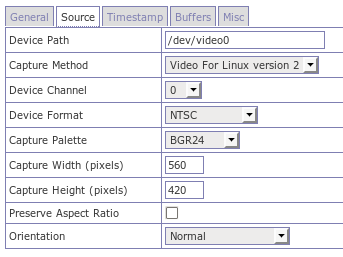

Re: Zoneminder problems with Unubtu 11.10 desktop
I'm not sure where the brackets come in, certainly not on the device path variable line. Device channel variable is the second zero he's showing in brackets but entered on a separate line without brackets as in:
- source.png (13.83 KiB) Viewed 6036 times

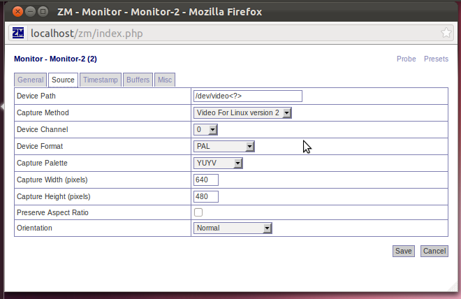

Still I am working to get Zoneminder to work. What is this wrong and how can I get it right?
ZM-Console: Source :dev/video(0) ! this is red !
Monitor: Source: Device Path: /dev/video<?> !Why this, I think, that it must be /dev/vido(0) !
Capture method: Video for Linnux version 2
Device Channel is 0, which is right.
Device format: PAL
Palete: YuYv and so on.
Device format: PAL
- source.png (39.63 KiB) Viewed 5745 times

As a cautionary note: by changing the resolution to 640*480 you may have compounded your problem if ./configure had mmap=no (using shared memory).
Probing this type of setup is useless as it's designed for network cameras not cameras on a capture card.
Your device is still incorrect; you need to edit it to read exactly as the screen shot I posted earlier (/dev/video0). I tried the brackets on my setup and doesn't work.
