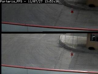

I've been using Zoneminder a few years ago, and worked very well, recently understood a lot of configurations, but now i'm stuck with a problem that i can't resolve, 1 of my monitors have its image splited (attached still image) . With xawtv it looks great, but with Zoneminder this happens. Knows somebody how to fix this ?

Split Image Problem On Monitor
- nph-zms.jpeg (10.12 KiB) Viewed 4180 times
Re: Split Image Problem On Monitor
Check "CAPTURES_PER_FRAME" setting (options::config). Or possibly disable "V4L_MULTI_BUFFER" (options::config). If neither of these fix the problem try Video for Linux 1 in the monitor source settings. One more thing I just noticed, try changing the palette to BGR24 unless your sure the one selected is correct (palettes seem to have changed with 1.24.2).
Just realised I never gave you a value for "CAPTURES_PER_FRAME", it should be 2 or possibly 3. Be patient in between changes, takes awhile to actually see the change after save.
the way fixed this problem was to....(in ver 1.22.2)
1. Make sure all monitor settings on the card in use are the same (i.e. resolution, FPS, ....)
2. Set max FPS to 2 or 3 On ALL 4 channels
3. Click on "Running" and restart the service (not the DVR)
4. Connect Cameras to all 4 ports
this has always resolved my problem and then i could increase the fps to 3 or 4.
also under EACH camera settings go to "BUFFERS" and set the following settings(will also reduce cpu load as well as help resolve the problem)
Image Buffer Size (frames) 20
Warmup Frames 10
Pre Event Image Buffer 10
Post Event Image Buffer 10
Alarm Frame Count 1
Warmup Frames 10
Alarm Frame Count 1
after a complete day testing , i can say that it works...
thanks for your help, now i can Modect ...
Bye.
Bye.
