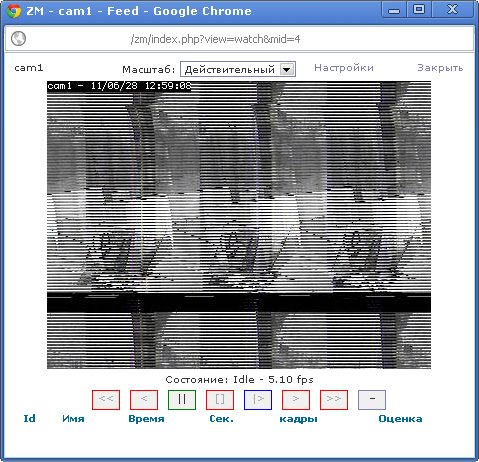

Does not work (RGB24)
How to set the resolution? The camera supports PAL 752x582 and NTSC 510x492 (written in the specification). Suppose I put the 752x582 and change the format of the video, but in this case there is no picture at all.
Conclusion: The need to set a different resolution, but what? and what video format? Too many combinations to enumerate.
Can anyone faced with this situation?

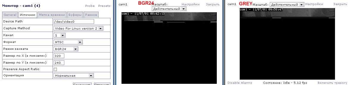

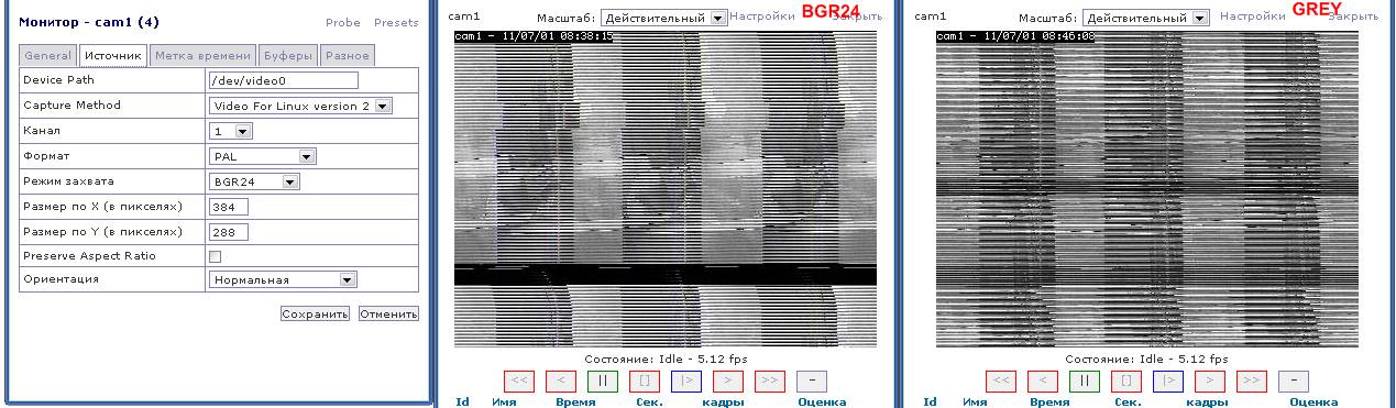

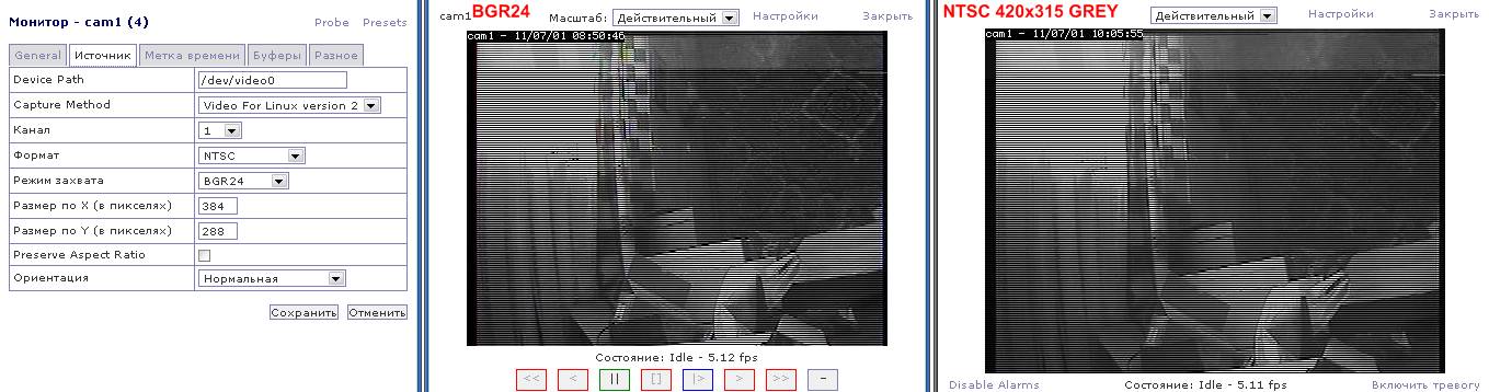

My motherboard has a single chip. Therefore I need to put: device channel: 0
After busting a few combinations was able to get something similar to the image from the camera. Still have problems with color.
Prompt where to dig.

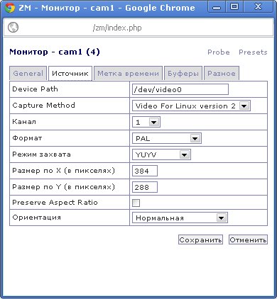

Re: Adjusting the Picture + Bt878
I use every time:
sudo modprobe-v bttv card = 0x69 tuner =- 1 autoload = 0
I'm not sure that 0x69 - this is my card, but it worked fine the other (small) camera in PAL resolution of 320x240 and YUYV.
I do not have a bttv.conf. Today, try to look into this direction. And look what exactly the chip is at stake might actually chose the wrong type of card.
