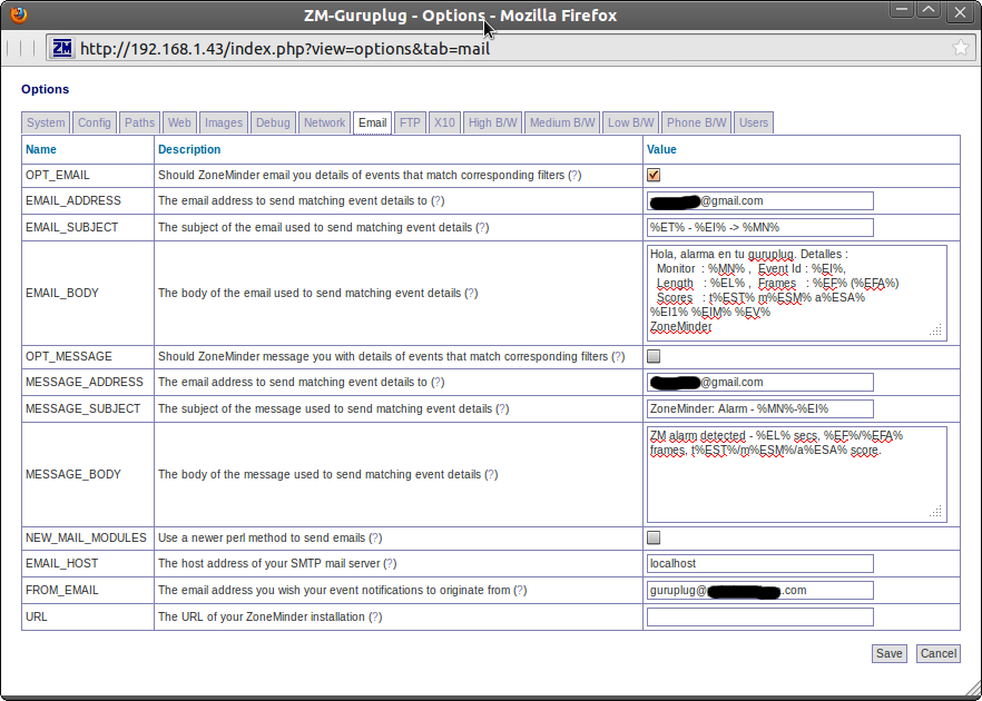

And here are the settings in the ZM mail config:
* OPT_EMAIL: checked
* EMAIL_ADDRESS: your email account
* MESSAGE_ADDRESS: your email account
* EMAIL_HOST: localhost
* FROM_EMAIL: any name you want (invented also works)
Hope it helps,

Find attached my config. Here's a good explanation of the codes to attach information to the email:
http://www.zoneminder.com/wiki/index.ph ... ing_Events
Regards,
PacoLM
email config
email config
Pantallazo-ZM-Guruplug - Options - Mozilla Firefox.png (93.33 KiB) Viewed 6969 times
