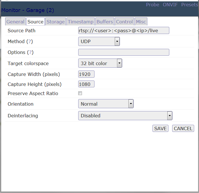

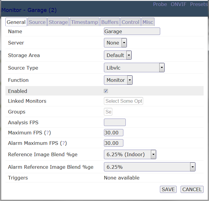

Sure, here you go (I'm just listing the ones changed from default settings):
General Tab:
Source Type: Ffmpeg
Enabled (checked)
Analysis FPS: 5
Max FPS: 5
Alarm Max FPS: 5
Source Tab:
Source Path: rtsp://<cameraname>:<password>@<your IP address>/live
-------for example: rtsp://frontdoor1:12345xyz@192.168.254.55/live
Method: UDP
Target Colorspace: 24 bit color
Capture width: 1920
Capture height: 1080
-- I also find that after saving the settings, I have to go to the camera and view it or the name and IP address show up in red, as if it's not working.
-- I don't think the FPS settings matter much, seems like almost any value I pick works.
-- 24- and 32-bit color both work on my system, I chose 24-bit to reduce the bandwidth a little.
-- I think the capture height and width are also somewhat flexible if I recall, but that's what I have them set at now (1920x1080).
Hope this helps!

Not sure if you ever got yours working, but I have my Wyze V2 cams running in ZM with the following settings:
Zoneminder v1.32.3 (running on docker)
Wyze V2 firmware 4.28.4.40 (this is the second rtsp beta firmware that Wyze released)
Everything seems to function normally. There is occasionally some stuttering, but I was getting that even when viewing the feed through VLC, so it might just be the fact that it is wireless. Turning the quality down to 360p in the app does seem to help. I did some basic recording tests and changing the video quality in the Wyze app seems to also affect the RTSP stream.
