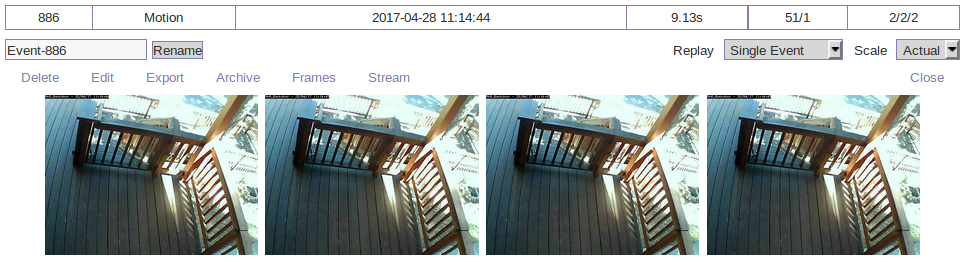

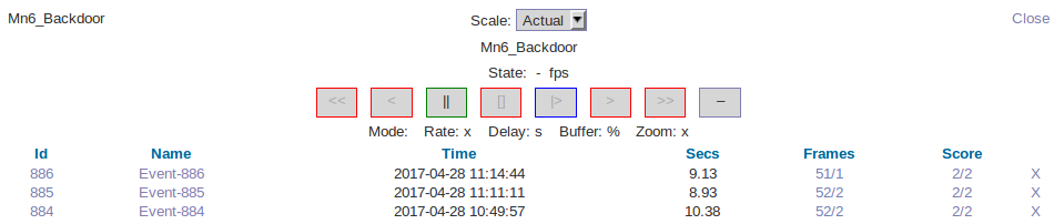

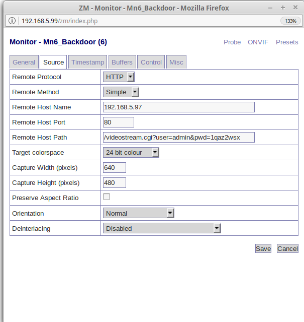

Rockedge, To answer your question ( Fri Apr 28, 2017 8:20 am) as it applies to me, "What Url .... "this is what is so maddening and disappointment, the url that I have in the Source panel is the same one that I use on three other ZM instillations and they all worked correctly. When I just paste this url in firefox it just works beautifully, " http://192.168.5.97/videostream.cgi?use ... esolution= 8 => 320x240 32 => 640x480 ". So to recap, I still have no streaming video when I click on the monitor in my case its "Mn6_Backdoor" its just a white screen, but I'm getting detection alarms when I click on the alarm/events I see no video. I have stills and if I click on the still I see the individual images making up what would be the video.
From all the reading I been doing ( and there has been a lot since April 24th) it should be fixed with the info here, "Why can’t I see streamed images when I can see stills in the Zone window etc?" - Again this is the info I first posted when I started this thread. See above. These are the same issues that Lilmissndemon is having.
But Here are the particulars of my setup.
Shows Source settings
Shows Monitor 6 with no streaming video but shows the alerts..
Shows Monitor 6 with 3/51 stills (frames) that would make up the video.

can you try this change in the camera setup?
Remote Host Name -> admin:1qaz2wsx@192.168.5.97
Remote Host Path -> /videostream.cgi
