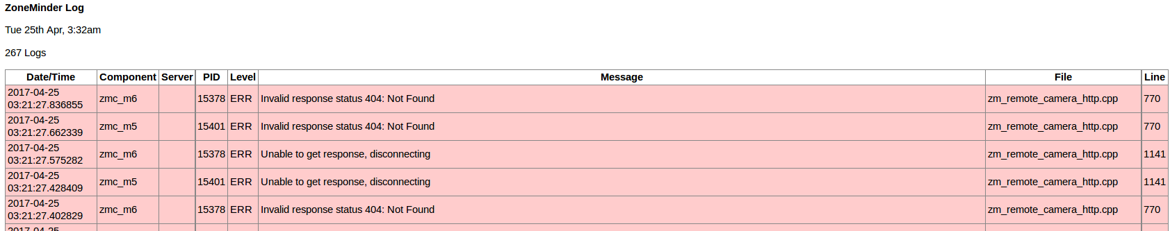

Here is a snippet of the log file.
zm-log.txt
(66.91 KiB) Downloaded 1811 times
Anyway I still have no streaming video from ZM when I click on the ZM console > name of the Monitor. I have events and I can see still images just no video. I need some help I'm stumped.

I was looking at some earlier logs I was getting a strange error
getStreamCmdResponse stream error: Socket does not exist. This file is created by zms, and since it does not exist, either zms did not run, or zms exited early. Please check your zms logs and ensure that CGI is enabled in apache and check that the PATH_ZMS is set correctly. Make sure that ZM is actually recording. If you are trying to view a live stream and the capture process (zmc) is not running then zms will exit. Please go to http://zoneminder.readthedocs.io/en/lat ... window-etc for more information. - checkStreamForErrors()
But this seems to be referring back to the same literature explaining , "FAQ for Why can’t I see streamed images when I can see stills in the Zone window etc?" namely, Check Apache /etc/apache2/conf-enabled/zoneminder.conf ScriptAlias matches PATH_ZMS.
ScriptAlias /zm/cgi-bin /usr/lib/zoneminder/cgi-bin. This I have already done and showed in my first post. The log file I attached earlier keeps referring to
Invalid response status 404: Not Found
Unable to get response, disconnecting
I'm just not sure how to read these logs to diagnose my problem so I can fix it.

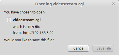

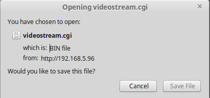

I keep getting these popups never had these before but they say videostream.cgi ... and I have noticed they seem to be coming from my different cameras as the ip address is different sometimes,
Any suggestions?

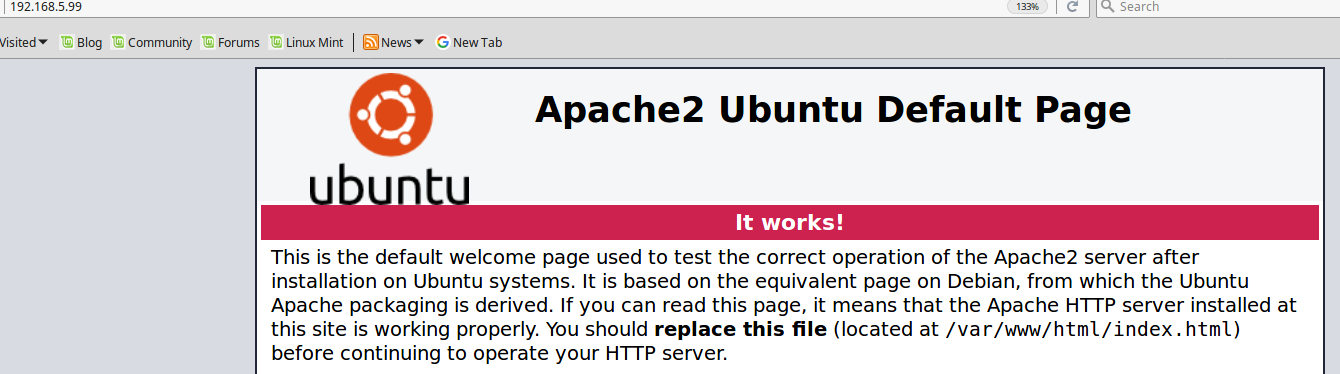

Yes apache is working I think correctly at lease this indicates it is.
