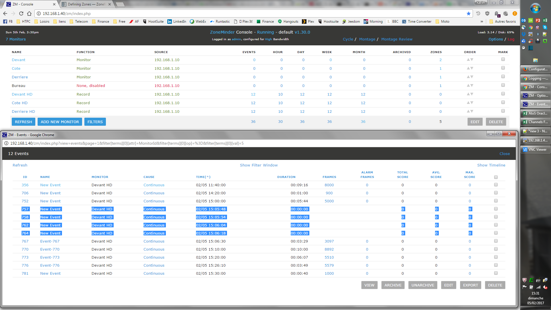

i do get this error message when my filter is executed:
Feb  5 14:29:06 SERVER zmfilter[6229]: ERR [Can't execute filter 'SELECT E.Id,#012                          E.MonitorId,#012                          M.Name as MonitorName,#012                          M.DefaultRate,#012                          M.DefaultScale,#012                          E.Name,#012                          E.Cause,#012                          E.Notes,#012                          E.StartTime,#012                          unix_timestamp(E.StartTime) as Time,#012                          E.Length,#012                          E.Frames,#012                          E.AlarmFrames,#012                          E.TotScore,#012                          E.AvgScore,#012                          E.MaxScore,#012                          E.Archived,#012                          E.Videoed,#012                          E.Uploaded,#012                          E.Emailed,#012                          E.Messaged,#012                          E.Executed#012                   FROM Events as E#012                   INNER JOIN Monitors as M on M.Id = E.MonitorId#012         where not isnull(E.EndTime) and ( E.Length = 00:00:00 ) order by E.Id asc', ignoring: You have an error in your SQL syntax; check the manual that corresponds to your MySQL server version for the right syntax to use near ':00:00 ) order by E.Id asc' at line 25]
I tried changing the length from '00:00:00' to 00:00:00 and with \: but always the same. Basically I just want to delete events with a null duration. Not sure why they get recorded though but at least I wanted to clean those.
Any idea of the right config to get this working? and potentially of what is causing null duration events?
Merci

Here is an example of what I am seeing.I assume I can tweak ZM to have one event per hour? What are these events based on? If the duration is 00 does it mean like that during x number of minutes not detection was done (Cameras with VBR) so nothing has been recorded since the previous file? That seems strange to me.
Re: zmfilter ERR Can't execute filter 'SELECT E.Id,#012
Duration should be simply "0" w/o quotes.
Oh, and a common reason for null events are an inability to write to the disk. Is the disk full? Are the right permissions set? Is the disk slow/failing? You need to look in your log for clues.

Hi Knnniggett
1/ Thanks this was the issue, now I see:
Feb 5 21:08:16 SERVER zmfilter[12641]: INF [Scanning for events using filter '_TempFilter1486325295']
2/ As the previous, screenshot the disks correctly accessible (it was a 69% and now is at 96%). I do have the other filter "PurgeWhenFull" kicking at 95% with the oldest 100 events to be deleted so normally the disk is never full.
3/ As per the log, I did put as documented in the wiki (http://zoneminder.readthedocs.io/en/sta ... ogging.png) but the file in /var/log/zm is empty and I don't have logs in the web page (even it is orange). I do believe I may have an issue there but I was thinking this was stored in the db rather than the file. At least I do get the logs in syslog correctly and don't see anything strange. Should I be looking at another place?
