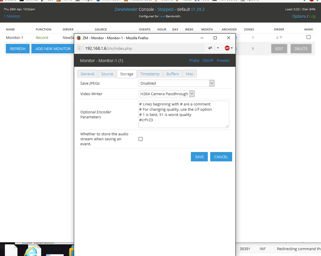

finally thank you guys I'll look around this and if every thing works
thanks again for your help <3
Screenshot 2016-04-28 10.53.16.png (58.46 KiB) Viewed 2573 times
