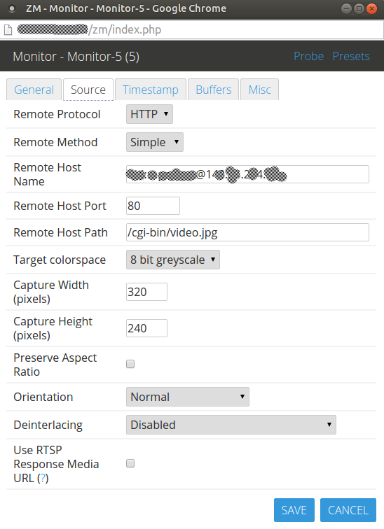

I am trying to configure a D-Link DCS-2100 with ZoneMinder 1.29 but getting the error:
01/08/16 16:49:37.065074 zmc_m5[5320].ERR-zm_remote_camera_http.cpp/1141 [Unable to get response, disconnecting]
01/08/16 16:49:37.662297 zmc_m5[5320].ERR-zm_remote_camera_http.cpp/1040 [Unable to read content]
The source config is:
USB Cams are OK!
I can't figure out what is wrong!
Any help?

From the wiki for the DCS-2100+ :
Note: you must change Network -> ZM_HTTP_VERSION option to 1.0 for this camera to work!
Did you do that?
Also, make sure your camera is actually sending a grayscale image, since you've told zoneminder it was grayscale.

jscmenezes wrote:I set up HTTP to 1.0
The only URL that works is (Firefox, Chrome..):
http://ip/cgi-bin/video.jpg
But that isn't the same url you are using in your ZoneMinder screenshot.
You should be testing with this url:
http://username:password@ip/cgi-bin/video.jpg
Since this is an mpjeg camera, you can test that url directly in Firefox.
Not all cameras support authentication in the form of user:pwd@host . Are you sure your cameras does?
That would certainly explain why ZoneMinder is saying the camera is not responding.
Suggest you try to get the camera working without any authentication. Once you get it working, then try to figure out if it is possible to enable authentication.
