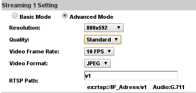

Hi *,
actually I'm referring to the following post "PLANET ICA-HM316" - from Wed Nov 23 back in 2011. The firmware used on ICA-HM316 is identical to such used on models ICA-HM132 and HM136 (indoor types).
So, while having the camera configured to stream MJPEG instead of H.264 - ZoneMinder throws the following error:
zmc_m13[4240]: ERR [Unsupported media type 'application' in SDP media attribute 'application 0 RTP/AVP 107']
From my understanding the expected profile for MJPEG should to be RTP/AVP 26 (JPEG Video) and not RTP/AVP 107.
Is this a misbehavior of the firmware/camera or does support has just to be added to ZoneMinder?
I also didn't manage to find the respective profile - 107 - referenced on the .. Is this some sort of combination between used audio+video profile?
As seen on the screenshot above the audio codec is G.711.
