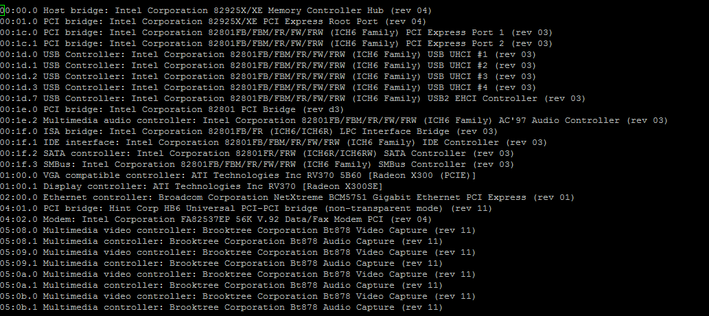

All four channels need to be 0 on the PV-149. Zoneminder doesn't see the cameras at all, it only deals with the capture card. Be sure the card is detected http://support.bluecherrydvr.com/entrie ... leshooting.
Re: Cannot get ZM v1.24.4 to recognize a Hawk-I CCTV camera
I followed the instructions from the Blue Cherry link you posted and attached the results. It appears as though lspci has verified the card is installed. I'm certainly no expert on kernel drivers but in my amateurish opinion, everything looks OK.
I again tried device path set to video0 thru video3 all with device channel set to zero. Still have the same issue.
