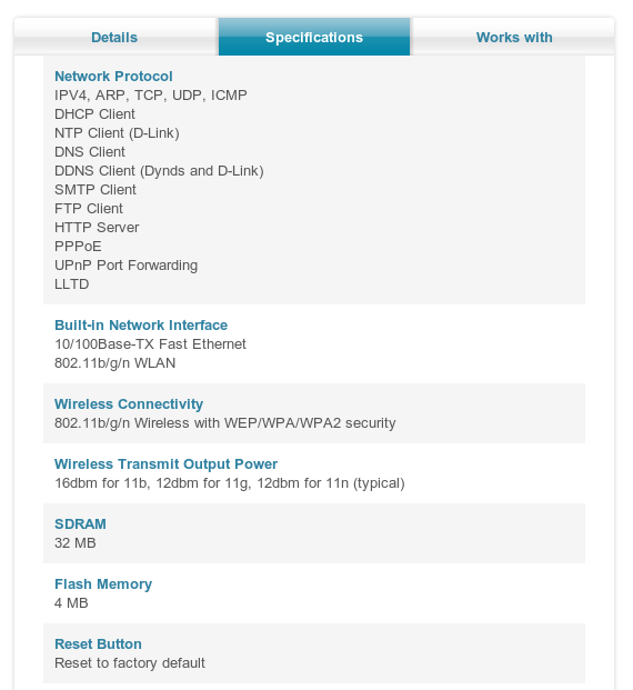

I'm thinking about buying two cameras to do some testing with. Specifically, D-Link Wireless-N IP Camera (DCS-932L). Will it do time-stamping for me? I don't see that in its specs.
thanks again, Chris

Re: timestamps for IP video
Yes the DLink does support NTP:
http://mydlink.dlink.com/DCS932L#tab2
- Screenshot.png (38.61 KiB) Viewed 4793 times

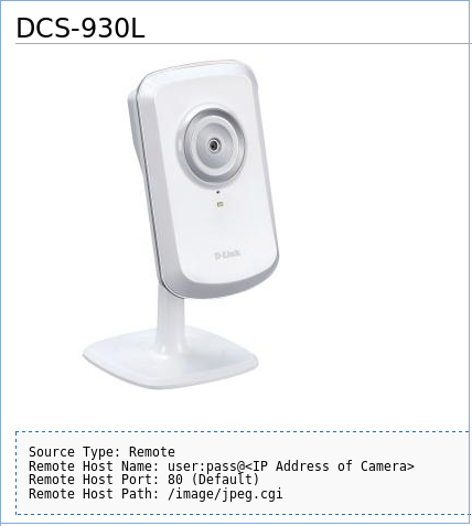

It does appear that the 930L works in ZM but can't verify the 932L
http://www.zoneminder.com/wiki/index.php/D-Link
- Screenshot-1.png (42.34 KiB) Viewed 4792 times
