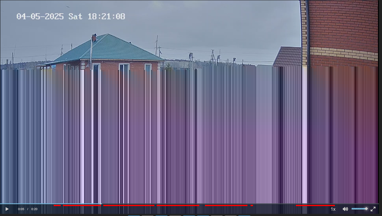

Good day! Tell me, what needs to be adjusted? Periodically I see such events on remote cameras, on cameras that are connected locally there is no such thing. Remote cameras are connected gre/ipsec
pls looks attachment
Screenshot 2025-04-05 184211.png (358.15 KiB) Viewed 1580 times

*_* wrote: Sat Apr 05, 2025 11:49 am Good day! Tell me, what needs to be adjusted? Periodically I see such events on remote cameras, on cameras that are connected locally there is no such thing. Remote cameras are connected gre/ipsec
Search the forum for the words "Smearing" "Blurring" "Tearing" ... you'll see that this is down to corrupted data in the network stream, which then causes the image decoding to fail in that way.
Some people find changing the streaming settings from TCP to UDP (or vice versa) improves things.
