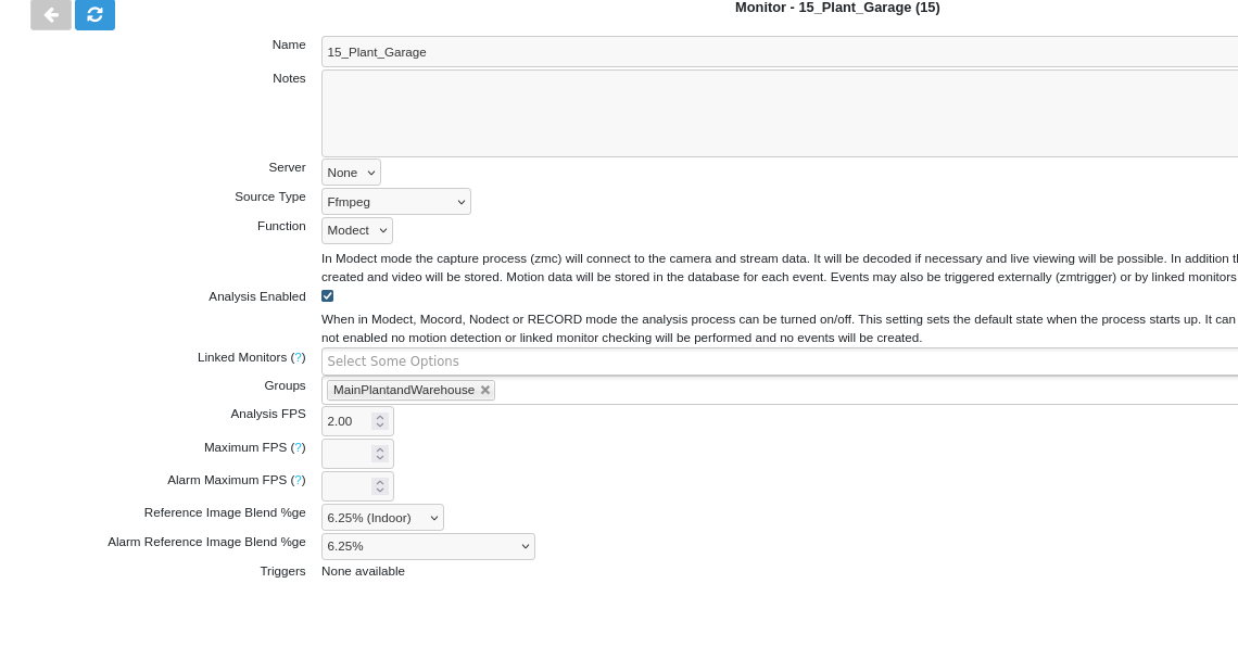

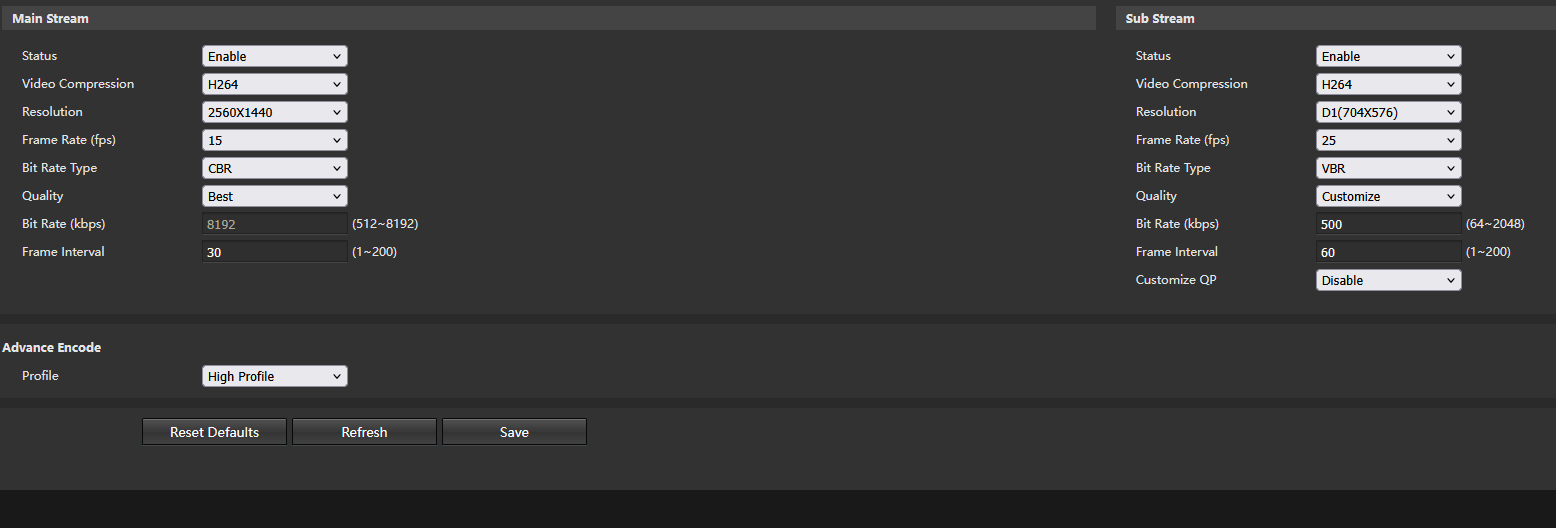

Idk... I got it into a "usable" state, but it is still far from perfect. Analysis barely keeps up, but I'm exhausted from such a simple project for very unimpressive results. I understand this program can be very good and amazing, and is built by people with a passion... But I suppose it isn't for everyone. Here are my final settings I'll use for now until I feel the need to upgrade to a Unifi setup.
- monitor source.png (14.13 KiB) Viewed 18803 times
- MonitorStorage.png (12 KiB) Viewed 18803 times
- monitorbuff.png (13.44 KiB) Viewed 18803 times
Re: Events with no EndDate, awkward lengths too
Other pictures
- camera.png (24.89 KiB) Viewed 18803 times
- monitorgen.png (22.8 KiB) Viewed 18803 times

Please go back and review the earlier post. There are multiple items on your settings that are not desirable. For example:wildfire wrote: ↑Thu Mar 20, 2025 10:09 pm Idk... I got it into a "usable" state, but it is still far from perfect. Analysis barely keeps up, but I'm exhausted from such a simple project for very unimpressive results. I understand this program can be very good and amazing, and is built by people with a passion... But I suppose it isn't for everyone. Here are my final settings I'll use for now until I feel the need to upgrade to a Unifi setup.
- Lower the resolution
- Disable frames / analysis images. any JPEG encoding (especially on a 2.5K stream) will use a lot of CPU. Use only passthrough.
- Copy what I have for the buffer page. Although you can use 5 frames for the pre and post event count (that is the default I think).
