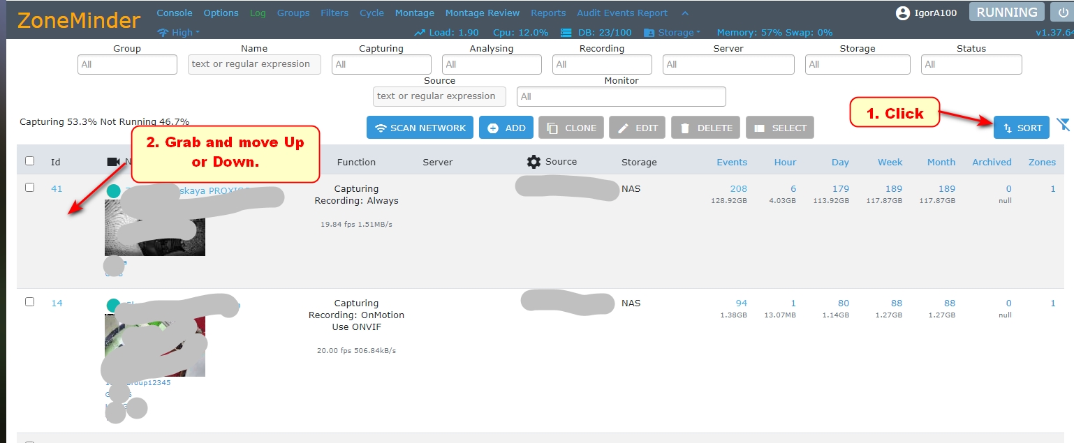

I thought in the past that I was able to re-arrange the order of the different monitors in Console display; that no longer appears to be the case.

RonRN18
Posts: 58
Joined: Tue Aug 13, 2019 1:00 am
Re: Order of monitors in Console display
Post by RonRN18 »
Thanks for that information... I had been hitting the sort button but it wasn't appearing to be doing anything. I didn't realize that it was a toggle mechanism.
