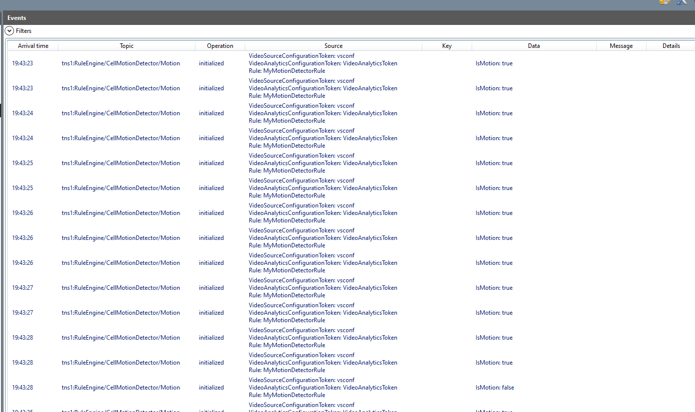

A couple of days ago they pushed a firmware update, tested in ODM and started getting responses from the event service.

I'll take captures from subscription to pull messages (during capture) on ODM in Windows and from the Zoneminder machine and place there here at some point this week.
Cheers.

I ran a capture on the Windows machine with ODM running and on the Zoneminder machine.
ODM sends a MessageID, Zoneminder doesn't.
ODM PullMessages request to camera:

Camera PullMessages response to ODM

The camera is returning MessageID to ODM.
Is this required for the response?

I also noticed the message limit for ODM is 1024, for Zoneminder it is 10.
The timeout setting for ODM is 1 minute, the timeout of Zoneminder is 20 seconds.
Again, I don't know if any if this is relevant.
Cheers.

Re: ZM 1.37.61 - ONVIF event messages issues.
Post by Primed73 »
I believe this was also happening in 1.37.60 builds.
Shall I spin up a VM and try a test install of previous 1.37 versions to see if it's ever worked for this camera?
Posts: 3373
No that would be a waste of time.
I've been trying to recreate this with my C520WS... at the moment it doesn't even send event messages...
Primed73
Posts: 23
Joined: Fri Jul 05, 2024 3:51 pm
Post by Primed73 »
Have you done a firmware update on the camera recently?
ODM wouldn't even read events until tp-link looked into the firmware fault and pushed an update.
Posts: 3373
NO updates available. ODM does not work with it. Hopefully soon.
Primed73
Posts: 23
Post by Primed73 »
It looks like they are releasing firmware this month to address this issue for the C520WS:
https://community.tp-link.com/en/smart- ... pic/666806
Posts: 3373
I'm pretty happy with this cam and once that firmware release comes out, I'll have to make some social media comments about it.
Primed73
Posts: 23
Post by Primed73 »
I am pretty impressed with tp-link's tech support and forums, as long as you provide them with lists of what is working and not working, what you have done to fix your issue and given screenshots, they get right on it and keep you updated on progress.
I think it was about 3 weeks from them diagnosing the fault, putting together working firmware and pushing it out to me.
Primed73
Posts: 23
Post by Primed73 »
Hi @iconnor,
Just out of interest, did they end up pushing a firmware update for the C520WS yet?
Posts: 3373
They did, I'm at 1.2.28 now... but event subscription doesn't work. Not in ODM or ZM. It doesn't understand the To: directive in the headers
Primed73
Posts: 23
Post by Primed73 »
I suggest creating a thread on the TP-Link forums, paste a screenshot of the ODM error, they'll probably escalate it to their internal support (like I said, they really are quite good) hopefully they'll push you an updated firmware like they did with me.
