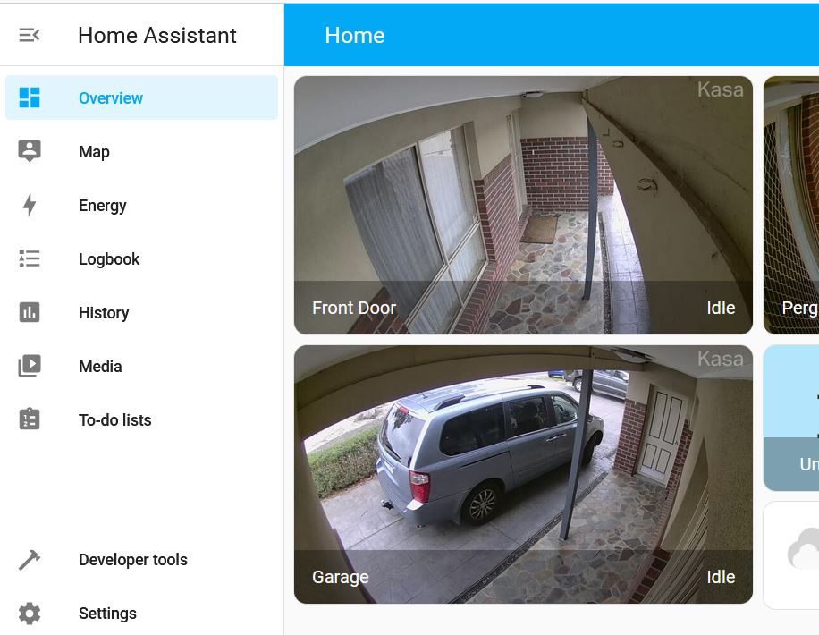

Now, further to this , i am then also able to make the 3 KC100's i have , work in 'Home Asssistant' , by using 'Kasa Cameras' add-on , which then enables a couple of output streams within Home Assistant, for the cameras, at ...
HLS ->
http://<Homeassistant IP>:43330/hls/<CAMERA NAME>.m3u8
RTMP ->
rtmp://<Homeassistant IP>:43331/live/<CAMERA NAME>

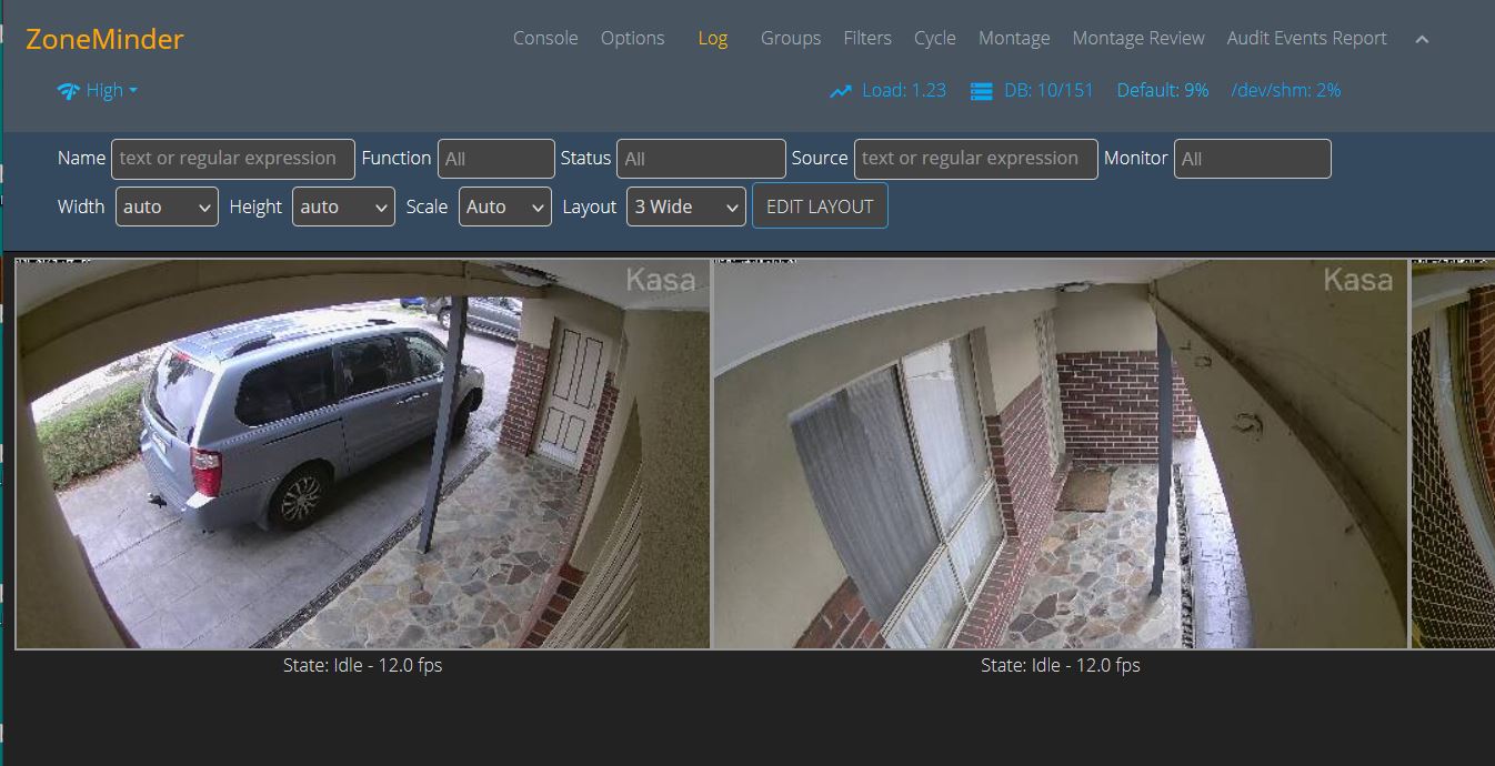

which i 'can' then plug that rtmp url into ZoneMinder as an ffmpeg monitor.. (Which works)!Image
BUT.. what i would like to do , is bypass the whole need for HomeAssistant.. while its an impressive product, i dont want yet another machine in the loop. But i cant for the life of me, figure out a way to add the cURL command/url (eg)
curl -vv -k -u Kasa@anon.com:UGFzc3dvcmQ= --ignore-content-length "https://192.168.1.38:19443/https/stream/mixed?video=h264&audio=g711&resolution=hd" --output - | ffmpeg -y -i - frontdoor.mp4
..and go directly from camera, into a monitor, that ZM understands.
