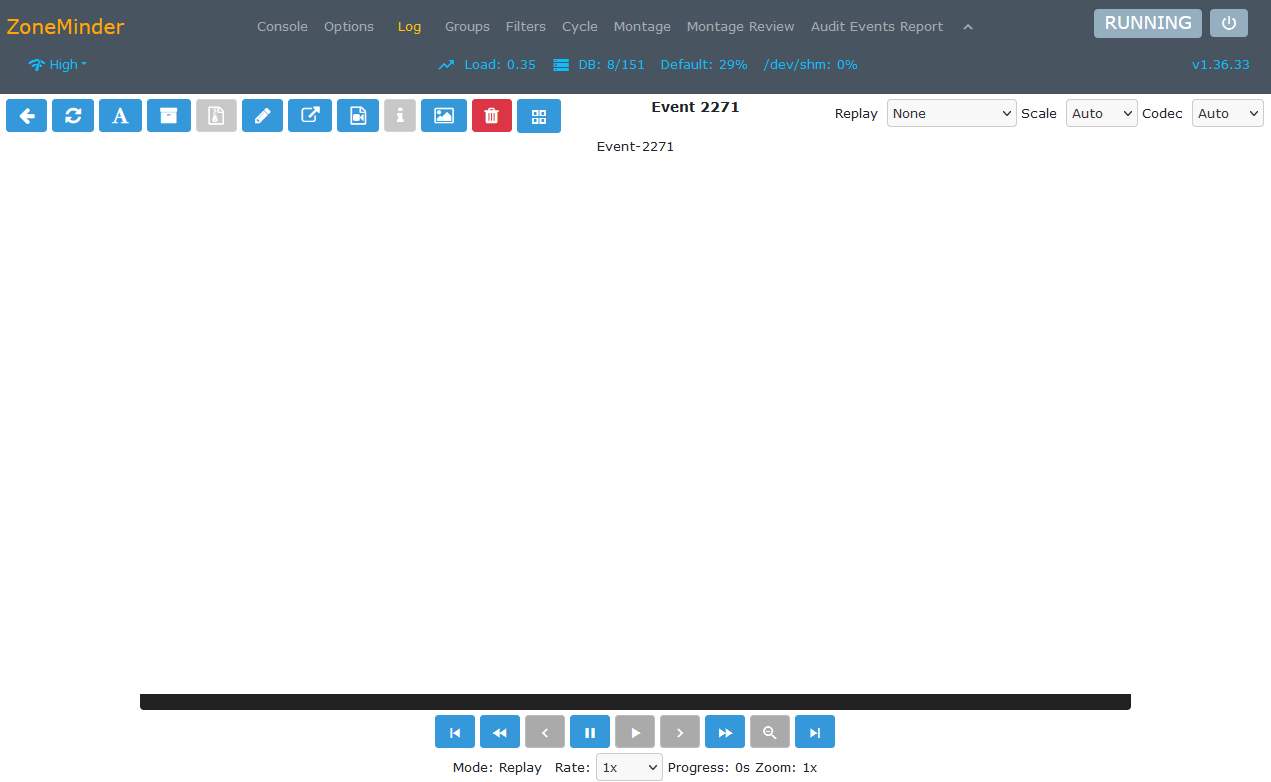

When I try to look at the events in firefox, I see the timeline, but not the video stream.
How can I watch the events in Firefox?

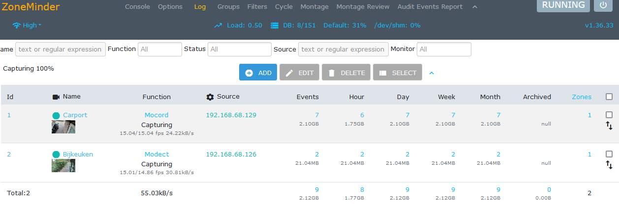

I'm using Zoneminder version 1.36.33 installed on a Raspberry PI 5 with 8 Gb memory.
Screenhots of console, live view and event view are attached, together with all the options.
I've tried al combinations of options M_WEB_H_CAN_STREAM and ZM_WEB_H_STREAM_METHOD, but no luck.

- Console.jpg (38.11 KiB) Viewed 16226 times
- Event view.jpg (31.94 KiB) Viewed 16226 times

I found out that the events do show when I use Edge as a webbrowser.

Looking for errors while trying to display an event I get the error :
XHR GET http://pi-paul.home/zm/index.php?comman ... est=stream [HTTP/1 500 Internal Server Error 47ms]
I've copied te info in the attached txt file.
