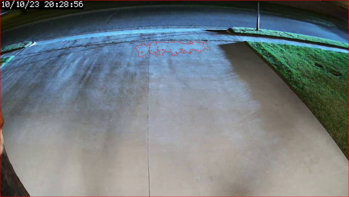

Second, one of my monitors is regularly alarming for motion outside of its zone. I don't know where or how to start with this issue because I thought the boundaries of the zone was Bible but I'm regularly getting recordings of activity outside of it.

2. Alarms occurr for events outside defined zones: By definition this should not happen. When you define a new Monitor there is a default zone defined which covers the entire field of view for camera. Did you remember to delete this one? I also have learned to just use the most optimal Zone Preset for my use case. In the past I tried to set all of the Zone parameters manually which was a mistake (for me, maybe not for ZM experts) ... after reading the ZM Documentation I concluded that there is TOO MUCH configurability and is very easy to mis-configure one setting box and really degrade the event riggering.

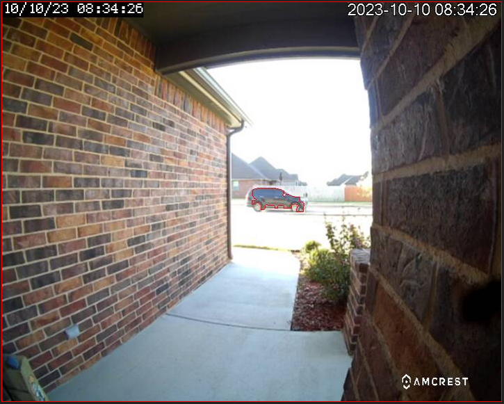

2. This one really bothers me and I'm not sure what to make of it. At first, I thought it was a result of modifying the boundaries of the default zone but, after deleting the modified zone and creating a new one, I continued to get alarms for events outside of the boundaries. For reference, here is my zone: And here is one of many events occurring outside of that zone: My hope is that, by correcting the issues above in #1, the issues of #2 will follow suit...
[FOLLOW UP] - I'm still getting notifications for vehicles passing in the street....

Issue 2: Still not sure how this is even possible. I did re-read the documentation Zone section (maybe my 10th time since using ZoneMinder in the past 8 years). In the Region Points section it is noted that 'It is possible to accidentally place a control point outside of the valid
coordinates of the image. This will prevent the monitor from working properly.'. The first thing to check is that there are no coordinates of the zone boundary that fall outside your camera resolution. The Sub stream for my camera inserted below is 640x360 pixels so the allowable range in the Zone setup is 0-639 for the x-axis and 0-359 for the y-axis. The 0,0 location starts at upper left of the image.
Issue 2: My second recomendation is to not use a single complex zone shape. I would break this into 2 or 3 zones that use only 4-5 coordinate points each. And make sure that the point coordinates are within the actual pixel range of your camera stream. Perhaps one zone that is close to the camera, one for the walkway and one out on the lawn. The event info will tell you which zones are being triggered and that may help you refine the zones even further. When I started using ZoneMinder I had way too many zones defined, today my cameras have 1-2 zones defined each. One other general comment regarding your zones is that you most likely don't need to cover the high areas of the walls. Only cover areas where humans will actually be in the images. This reduces the number of pixels being analyzed (CPU use) and will reduce the number of false positives such as headlights or shifting clouds that change the brightness of the high areas of the walls.

Well, a few follow ups. I was able to solve issue #2 by deleting and recreating the offending zone. I'm guessing something got tweaked just enough during the reconfiguration of the monitor that, as you suggested, one of the points ended up outside the actual scope of the image.

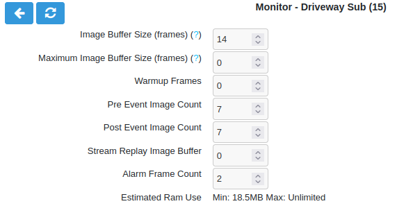

My thought for your case is that this is most likely due to the camera setup (FPS, keyframe rate, and whether the FPS and keyframe are variable or constant) and also the Monitor Buffers settings.
My camera firmware luckily allows the FPS and the keyframe rate to be set constant so this should help ZM analysis to be more consistent. My keyframe rate is set equal to the FPS which should be a keyframe every second. The keyframes and how often they appear in your stream are most likley very important for ZM analysis.
Monitor Buffers need to be set appropriately. I may have to make more adjustments to get my linked triggering to 100% but my strategy is to set Image Buffers to 2xFPS, Pre/Post Event Count equal to FPS. Probably increasing these could help but I was attempting to reduce memory/CPU requirements. One of my Sub Monitor Buffers is shown below.
Cheers and hope this helps. Let me know how this works for you and if you can increase your linked triggering.
