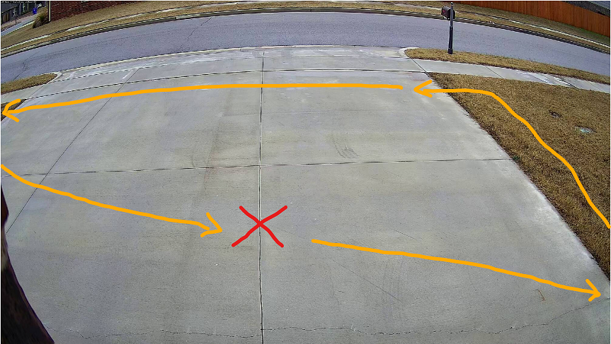

I've added a new camera to my house and I'm struggling to get it to record events as expected. It is placed over the garage doors looking down into the driveway. I've set up 2 zones, one on the concrete and one in the grass. I've used linked monitors as I read that processing on the HD stream can be resource-intensive. The HD stream (set to Nodect) is linked to the SD stream (set to Modect) where I've configured the motion detection.
The issue is that obvious motion events (such as an adult walking through the frame or cars coming/going in the drive) are not being triggered, regardless of which preset I use for the zones, but large events, such as headlights sweeping the drive or a lightning flash, will. As a test, I will walk the path marked in orange on the attached screenshot to attempt to trigger the event; my driveway zone goes to the near edge of the sidewalk and covers the visible concrete.
Walking through the grass is never triggered, nor is the path across the end of the drive. I will wait in the side yard for a few seconds, to run out the buffer, then return to the start. Generally, motion isn't detected until I'm at the red X where, because of my height and the placement of the camera, my head goes to the top of the trigger zone.

Re: Events not being triggered as expected
Try changing your Zone units from % to pixels.
ANd reduce the minimum values to around 500
Thank you for the suggestions, guys; that got things working as expected!

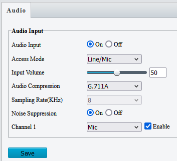

Not a ton...
And just to make sure I didn't do something dumb, here's my setup in ZM:
- Posts: 1377
- Location: San Diego
See if there's a g711 or g.711 no "U" That'll prolly work.
Well, I do have a G.711A but it's my only other option...

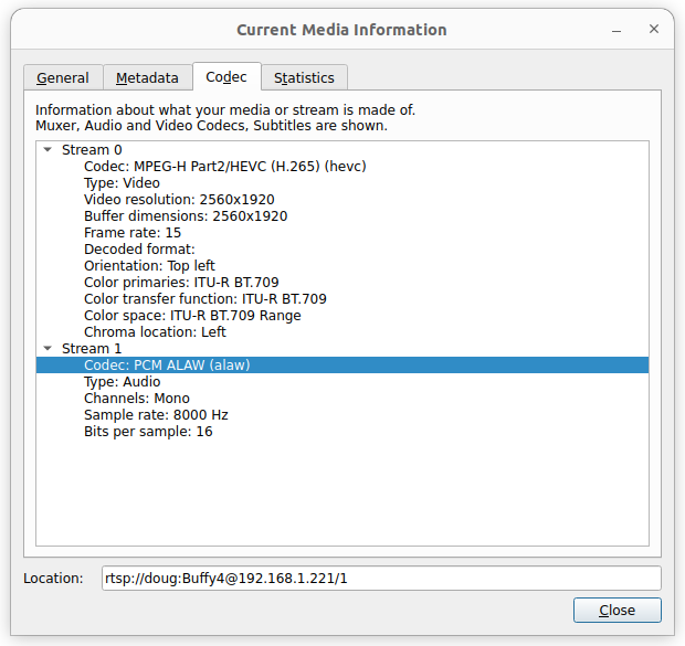

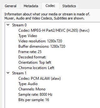

And here is the new codec info
Just so I know what I should be expecting - should I hear audio in the web playback in the ZM Console? I'm not getting anything there or in the exported videos. Are there any known issues using Firefox?
