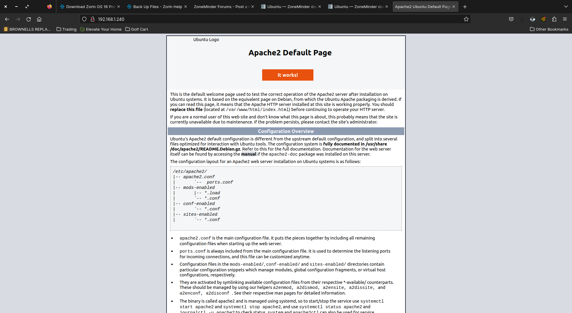

Hi pat2
I followed you instructions and still have the errors. I reinstalled Ubuntu too.
The answers are in bold and underlined
The code for the errors are below too.
Thanks for trying to help me. I understand that this is not a help desk for Linux n00bs.
Hobs

404 File NOT FOUND
hobs@Ubuntu-Server:~$ sudo systemctl restart apache2
Job for apache2.service failed because the control process exited with error code.
See "systemctl status apache2.service" and "journalctl -xeu apache2.service" for details.
hobs@Ubuntu-Server:~$ sudo apache2ctl configtest
Syntax OK

Hi Hobs,
that's the routine I follow for 22.04 on my Odroid board and on a 22.04 virtual machine (on Win) that I occasionally use to make experiments.
And it works.
Currently my production environment is on 16.04, development environment is on 22.04.
Probably missing/mistaken any step in your 22.04 installation or you didn't restart from scratch (did you do?).
The strange it seems the config test is OK and you are able to reach the apache web page (that tells "It works").
But the system doesn't allow you to reload the apache service.
Before trying the instruction by Bunge or Isaac please, as suggested by the system, try to check
sudo systemctl status apache2.service
and
sudo journalctl -xeu apache2.service
and let's know please.
It will provide more detail about the error. You have an issue on the Apache web server installation (that is the more easy part! :-) ). Hope it will more clear after you will tell us the details.

Hi pat2
I tried the code you suggested and posted the results below.
I also tried to follow the install instructions over on digitalocean and had the same results.
Maybe I should install 18.02
Hobs

The index page is the same as the Apache2 Default page.

really strange error. It seems you are already using ports. Really strange for an installation from scratch.
Let's try with a fresh installation on 20.04. It's my way to be sure you will start from scratch.
And then please execute exactly the instruction by bunge.
Let us know please.
