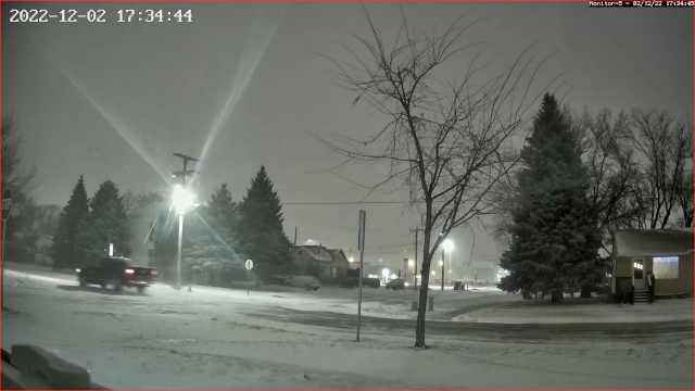

I got this camera a few weeks ago it is super nice with wifi, but it has a rj45 port also which I like. I havent figured out how to control the camera with zoneminder yet. Other then that everything works, and if you go with ethernet cable no need for the zosi app unless you want to move it around.
Model: zosi ZNC2893Y
Purchased from walmart manufacturer part number is 1NC-2892A-W-US on there website.
Main stream: rtsp://yourip:554/video1
Sub stream: rtsp://yourip:554/video2
I went ahead and disabled the IFR too shoot through a window at night as I'm in a apartment. If you're interested in doing that you need too remove 4 phillip head screws, and then remove the big all red connector.
