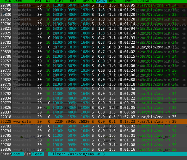

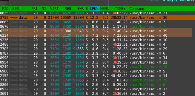

It's also possible to use the high res stream for two monitors and just downscale the resolution in ZM by a factor of 1/2 (or 1/4, ideally you have something around 320x240) for the analysis stream. This doesn't use any CPU for zma, and works a treat. See below. To be clear I tested this in 1.34.

monitor 39: high res stream, (1920x1080) put in zm as 320x240 (ffmpeg), modect.
monitor 40: high res stream, record
zma -m 39 uses very little ram even though the stream is originally 1920x1080.
Normally it would have CPU use such as in img htop3.
It appears that ffmpeg converts the video stream to 320x240 before analysis. (as both
ZMC processes are equally 7%).

htop3 shows all ZMA processes. The max CPU used is near 30%. Easily
10x more CPU than monitor 39. Probably 20x. There is the cost of two zmc processes,
but the savings are still significant.
Notes:
It's also possible for some cameras (including this one) to have a low
res substream by default, which would lower zmc to <7% CPU. But here,
it's not necessary. For ARM boards it might be more useful.
Camera used is Axis p3905-r.

- htop1.png (107 KiB) Viewed 11776 times
- htop2.png (175.72 KiB) Viewed 11776 times
- htop3.png (252.31 KiB) Viewed 11776 times
